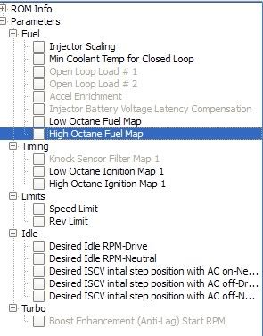

The reason my ecuflash has all the options working is because I have been testing Flash's definitions. He definately knows wtf he's doing.
Nice, but is that maybe what Jason may have meant.... That you can add more map definition but the ECU won't read them? How can you be sure? It must be in the code somewhere....
Thanks, I'll go through that stuff.

Hey, I just read your attachments. The first one talks about rescaling the maps for higher load.... beyond 100% (or 5.6 which is the scale they use in the uk).
So, I'm a little confused: did you hit 100% at 8-psi or did it happen at 1-2 psi? The bad news is that the ECU might just use the maps at the 100% load range for all engine loads above 100%. The good news is that rpm level does not remain static, so you can account for higher engine load with rpm level, but it is not as precise.
The second article talked about using closed loop all the time and I totally disagree. What the author neglected to mention is that closed loop operation takes time... meaning in some cases, the ECU can't tune fast enough for certain situations and engine damage can occur. When your on the highway, or have engine loads below 30-55%, the ECU can do its thing with closed loop. It's better for fuel economy and emissions. However, if I look a your high octane map, at 2500-4000rpm you are at 14.7 @ 50% engine load. At 60% load, your maps drop to 12.5, so that needs to happen rather quickly and being in open loop at that time would be better.
I didn't ask before, but did you change your open loop maps?
Thanks again for the info.

This tune is good for 13 psi
Right on.
I can't tell, but it looks like you changed some settings in Open Loop #1 (my maps are for the 6g72 so they might be different) and Open Loop #2 seems unchanged.
My plan is to have Open Loop #1 engage at 30-40% and then trim Open Loop #2 back to 60%. Both would be earily in the rpm/load range.

I wonder if Jay would mind explaining how the different settings affect the tune? Like accel enrichment etc.

i may not understand, but those fuel maps arent drastically different than stock.

If you look at the mid rpm & load range, DNS-EN's maps richens up much quicker than the stock maps (I don't have the GS maps to compare, but they can't be much different than the 6G72). That can be all the difference in the world. Most detonation damage happens before WOT.

Actually the gts and gt maps are alot leaner. Heres the stock gs fuel maps compared to the ones I modified.

Yeah, and that is why the 6G72 is a pain to tune with a piggyback. It can be done, but if you don't tune the middle part of the rpm/load range, you can expect detonation there.
Again, thanks for posting your maps.

I just wanted to let everyone that has posted a ROM know that I will try to write the definitions within the next few days. I have about 7 ROMs to go through. I have been staying pretty busy with my car lately. This DOHC swap is bad ass.
You the man! Care to tackle any GT/GTS roms?

I'm going to do my best with all of them. At the very least, they will have injector scaling, rev limit, speed limit, immobilizer and fuel and timing maps. That would be more than enough to get everyone started.
If anyone hasn't done so already, post up your ROM or send me an email.

How come many things are now disabled?
LogicGate is offline   Reply With Quote

Were you able to look at your ROM before?
FlashBlueRS is offline   Reply With Quote

Quote:
It would open using the 2001 Eclipse GT xml i think that came with the software. The only ones that doesn't show are the boost and the knock

Old 06/29/2006, 07:23 PM   #637 (permalink)
Zero Resistance, LLC
FlashBlueRS's Avatar
Join Date: Jan 2003
Location: Charlotte, NC
Vehicle: 02 DOHC Eclipse RS
Posts: 1,877
FlashBlueRS has a few friends hereFlashBlueRS has a few friends hereFlashBlueRS has a few friends hereFlashBlueRS has a few friends hereFlashBlueRS has a few friends hereFlashBlueRS has a few friends hereFlashBlueRS has a few friends hereFlashBlueRS has a few friends hereFlashBlueRS has a few friends here
Your ROM from your ECU could not be opened using any of the xml files that came with the software. Your ROM's identifier is 86720008 and I had to make the xml file for it. Because I had to make it, many parameters are not disabled. It's the opposite, a few parameters are now enabled.

Posts: 1,753
LogicGate seems to be okayLogicGate seems to be okayLogicGate seems to be okayLogicGate seems to be okayLogicGate seems to be okayLogicGate seems to be okayLogicGate seems to be okay
Send a message via MSN to LogicGate
I apologize Yours have all the data organized. Just these settings are not showing
It would take some time to find those. If you change your user level to advanced or developer, you would see that there are 59 parameters that are not available.
For anyone that hasn't actually seen the hex code, I found a way to convert the ROM to a text document so I could show you exactly what you are dealing with when trying to find parameters and create the xml file.
ROM Text
That is 16,384 lines of hexidecimal code that needs to be sifted through in order to find the parameters.
ROM Text
There is not way to change it to assembly or c/c++ code?? I noticed also that most of the settings available in developer will not work with our processor as far as I know

Are you using the hex patterns from the evos or other roms that are fully defined? If so I am sure I can help decode it.

Quote:
That's how I find the easy stuff like fuel and timing maps. I have IDA Pro Standard so I can disassemble the hex files, but I am having a hard time finding the SDK for the Hitachi SH series processors that comes with IDA Pro Advanced. Once I'm able to dissassemble the hex file i'll be able to do alot more.
I have found 30 parameters on my personal ROM by just comparing with other ROMs and completed xml files. It is just a guess and check process and I would never make an xml file available for download that I did in this manor. I don't want to be blamed when someone blows their car up.
