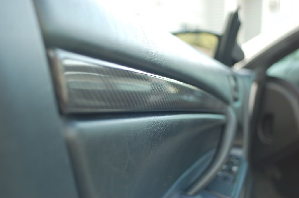

The passenger side:
The driver side:

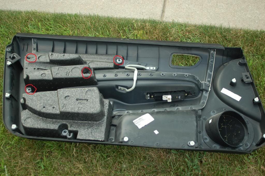

1. Take the panel off.

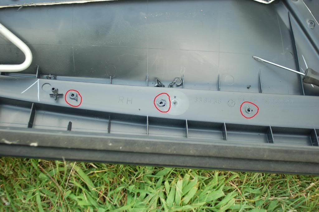

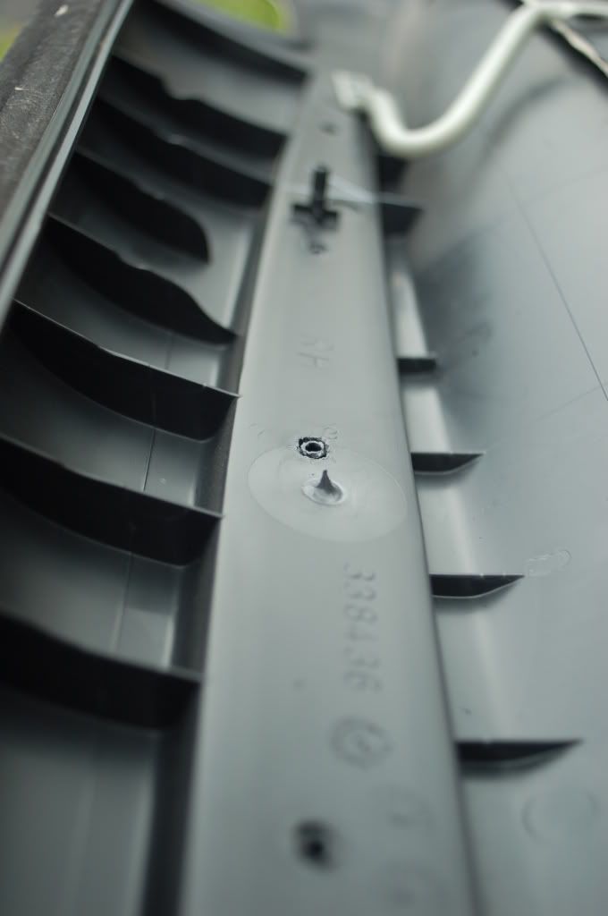

2. Once the panel is off, take the three washers-like locks holding the inner-pannel. [pictured]

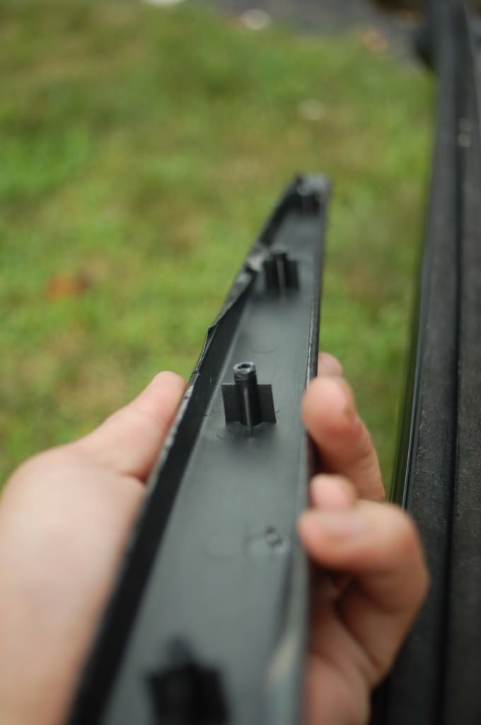

3. Now, you should have access to plastics mounts, holding the strip to it's place. [pictured] Take those out by carefully popping/cutting the heads off. - do not ruin the lower part, you will need them later.

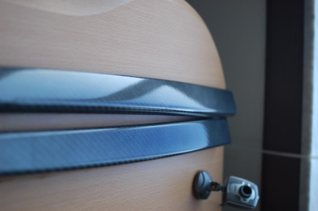

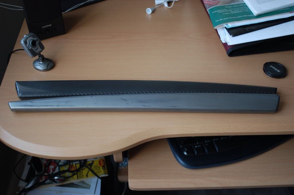

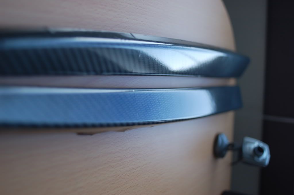

4. Strip should fall off the piece. Sand them down and make sure to clean the dust off. With sanded and smooth surface, you can apply the CF vinyl sticker. The corners are tricky, but cutting on the right place will fix that.
5. After applying the sticker, clear coat them to make sure they'll shine longer and also to make sure the corners of the sticker won't peel off. I did two coatings. Let it dry.

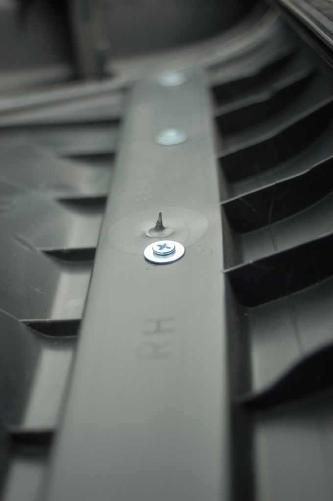

6. Now that the sticker is on and clear coating is dried. Time to put them back on. Start with shaving the rest of the plastic mounts down until it levels up to the top of the outer panel. [pictured]
7. Now using the washers and screws. Reattach the strip back to the piece. Careful in screwing them in, you don't want to break the plastic.
