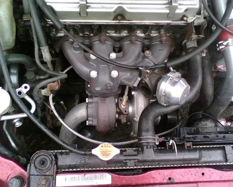

That's an S-10 fan. Fits better than the stocker. The Zirgo burnt out first day, I wanted to do a push/pull setup. I need to have a dump made up.
I've been having a lot of fun with the T-Pro. I disconnected the O2 sensors so the car is in open loop at idle and part throttle. T-Pro has a feature called PTT (Part throttle tracking) which allows me to set my desired idle and AFR at idle. I also set my cruise TPS number and set an AFR. In addition the T-Pro has a WOT Tracking feature that does the same shit. I let the T-Pro make the corrections then adjust my fuel trims to get the T-Pro's corrections closer to 0%. So far I'm loving it :)

Where is your intake pipe
Are you using blow through or map sensor with maft pro?

I just have a filter on the end of the turbo right now. Fits in there nice. I'm running the speed density function on the T-Pro with the GM 3 bar MAP sensor and the IAT sensor.

That upper radiator hose needs to go and I'm about to have the dump made up... I really just need to get that engine bay cleaned up

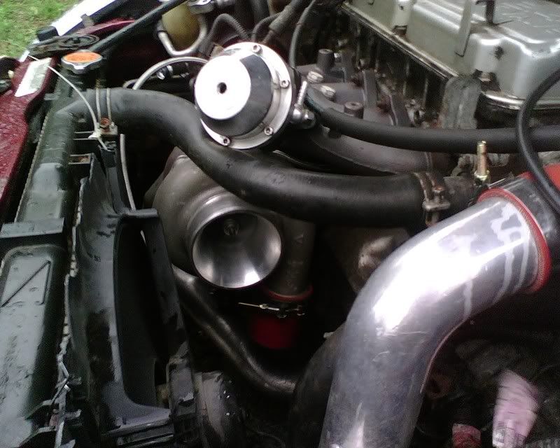

where is your lower intercooler pipe? I wanna see a pic so I know how to route mine
Yeah, just notice that radiator hose haha. I knew I should have gotten a MAF-T pro... I just have the MAF-T. I'll do a search on their differences.
I'll upload what I have and get you some detailed pics of all my piping tom. afternoon.

i didnt notice the throttle cable resting on the manifold and wastegate when i looked at these from work. lol lesson learned, i guess.

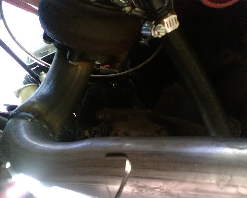

the downpipe doesn't look like the finest bent piping but it works, only a 2.5" downpipe though?
anyways, rig up an extension for your radiator hodse to get it out of harms way and post some better pictures!

The pipes he did a kick ass job on, I'll get some angles underneath the car so you can see.

All the piping is made up, I have to snap a pic of it. This was earlier in the day
