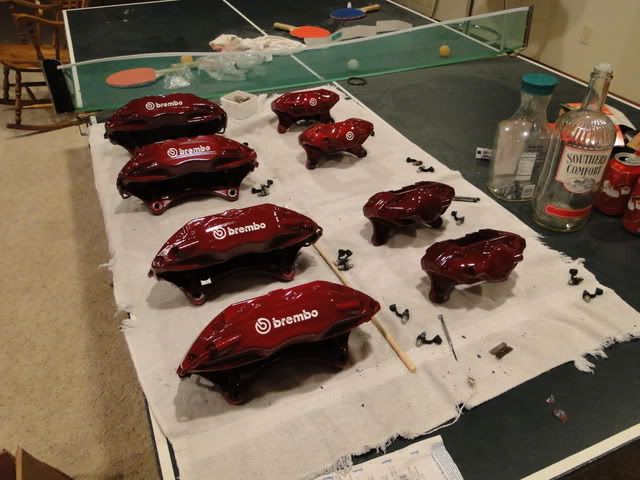

Now as you see in Voodoo's thread, he used aircraft stripper and a pressure washer to remove the factory paint. Timster had his sandblasted, and I am doing the same. For sand blasting there are some things you MUST consider. First, the piston bore MUST BE PROTECTED!!!!!!!!!! The shop doing mine bought 40 and 46mm plugs to fill the bores, but people have packed them with duct tape and kepts an eye on them to make sure the media was not blasting through the tape. Second, if you notice there is no external brake line between the 2 sides of the rear calipers. That is because the fluid travels through an internal passage, which means there is seal between the 2 halves of the rears. I do not know how the baking cycle of the powder coating process effects this, but I have seen nor read nothing that should cause concern. If someone knows please say something.

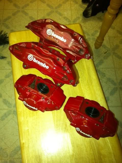

Obviously you are buying your brakes used, and have no idea what condition they are really in, also they are going to be a little worn seeing as how the factory clear coat is total garbage and just a little brake fluid/brake parts cleaner is all it takes to start failing, like this:

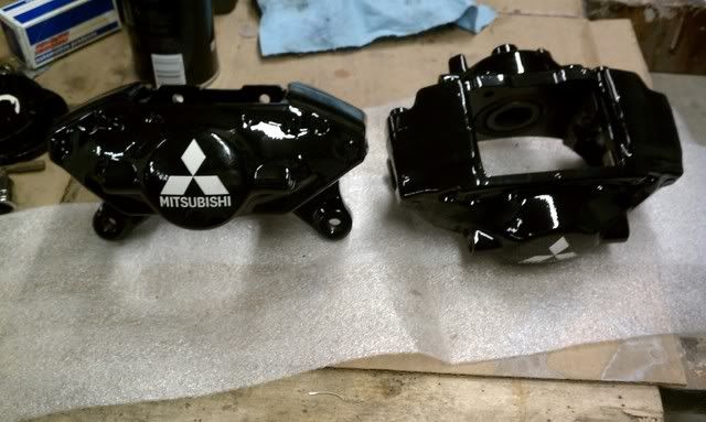

Powder coating is a great oppurtunity to completely disasemble your calipers and check the seals, pistons, bores and dust boots, while at the same time preparing them to look brand new. Kind of like this:

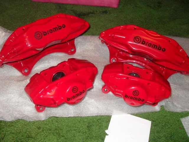

http://www.club3g.com/forum/vendor-sales/130331-powder-coating.html#post3150933 - member in the vendors section who coated timster's calipers, heres some pics:
