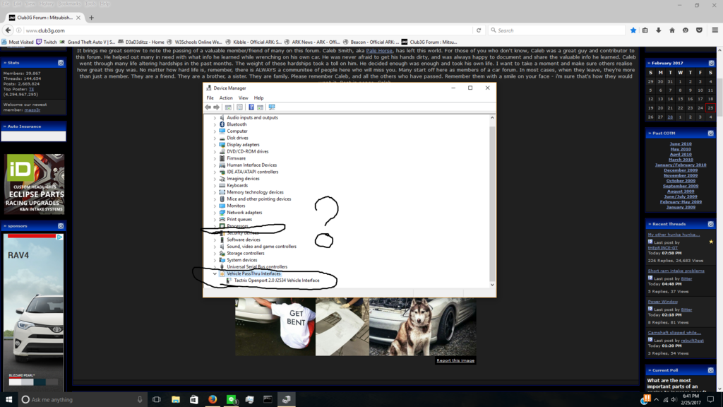

I'm having an issue getting my ECUFlash to read my ecu, I plug everything in and I've read that it needs to be on a com port but when I go to my device manager the tactrix cable shows up seprately from my ports (in fact I don't have a listing for ports at all) and there for can't get ECUFlash to read anything on my car. I have the 2.0 cable and I've put a sdcard in the OBDII conecctor with a logcfg.txt file and it wasn't logging to hat either, from what I read here in the forums it should just log when it starts up since I have absolutely no parameters set. I hope to get this resolved soon so I can start at the very least data logging so I can learn more about my engine before I try to tune it.
I appreciate any help provided to me

I have the 2.0 and as you can see from my picture in my opening post that it doesn't read correctly, I've tried ECUFlash and mitsuscan and neither will register anything from the car. I'm getting a product key from my dad for Windows 7 later today so I can put that over my Windows 10 lol.
