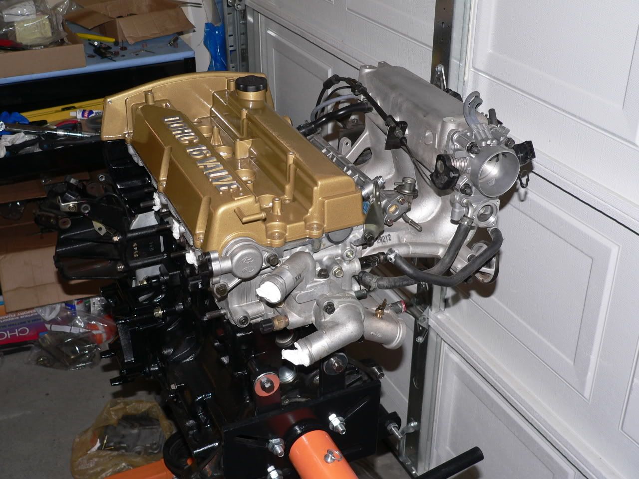

here is a picture of the evo TB on a hyundai intake manifold
here is a picture of the hyundai motor if you zoom in you can see the hyundai IAC
