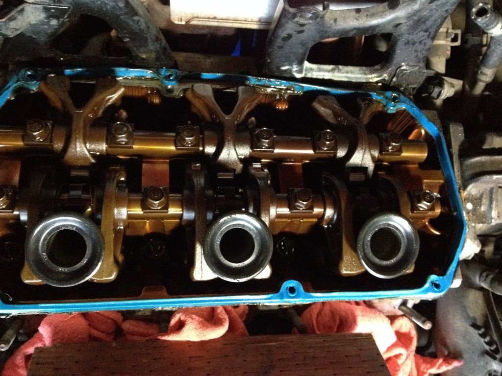

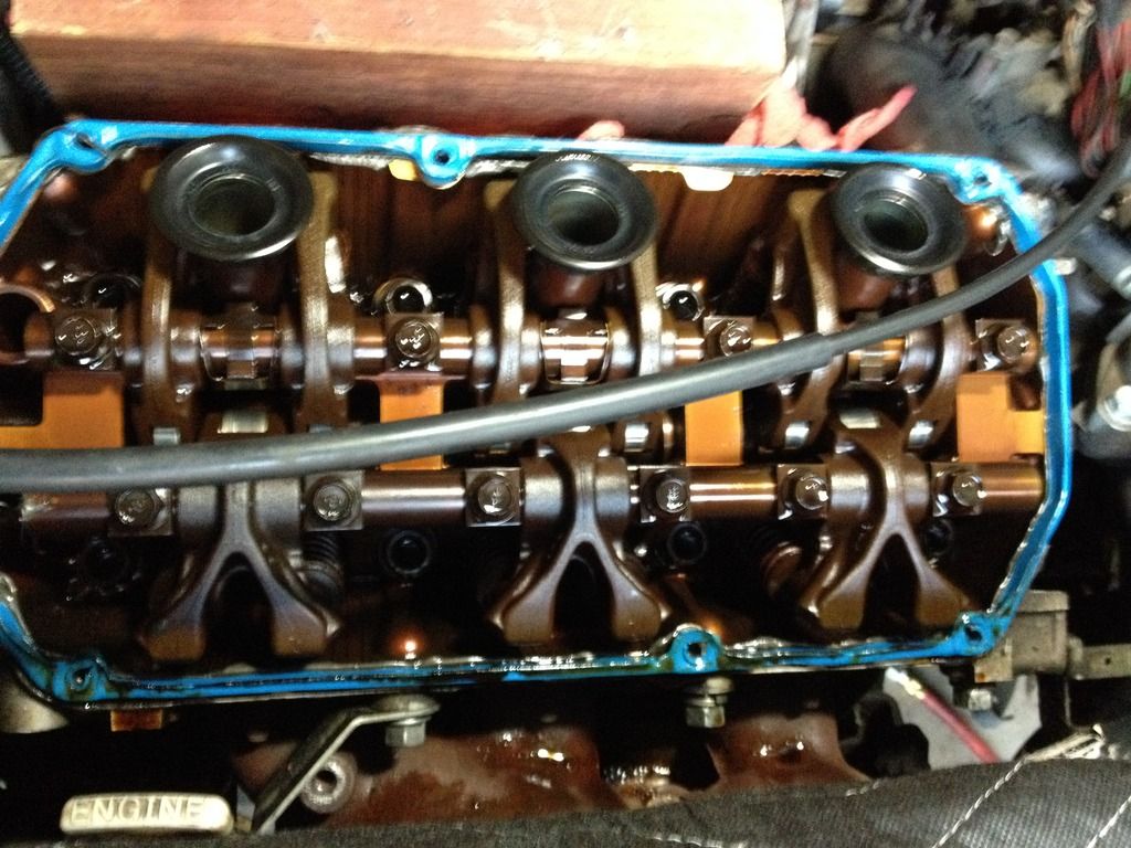

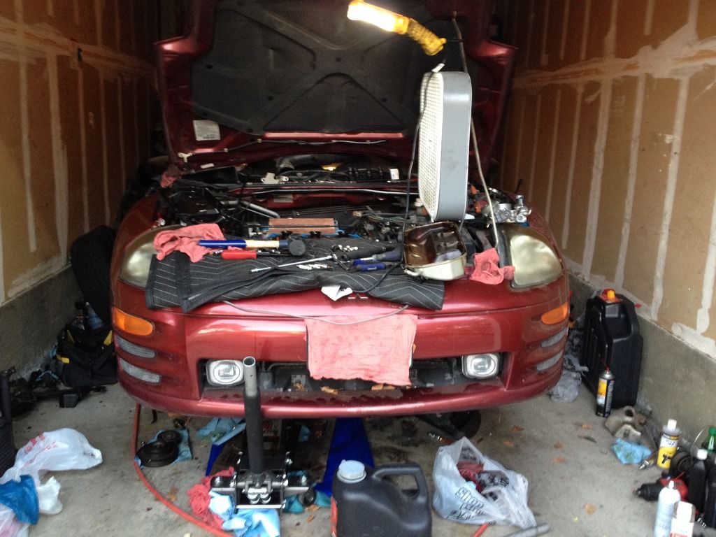

Picked this car up in July of 2016, and have been very slowly fixing it up. Bought it for $1k knowing it needed a head gasket(among several other ones), a timing belt, and now struts. Haven't taken any pictures until yesterday, so it's already apart. Just need to remove a few more things and get to measuring the surfaces. I'll be using a complete head gasket set from Fel-Pro, new cylinder head bolts from Fel-Pro, and new NGK Laser Iridium Plugs since I'm already down there. The spark plug wires look good, so I'll be skipping those.
Car lifted up in my tiny apartment garage:

Front Bank Close-up:
Rear Bank Close-up:
