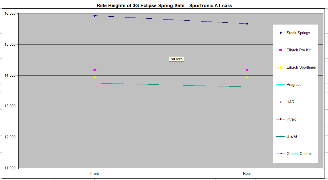

Seems like they aren't. I have no idea why.
But here are the graphs:

LOL, thanks. I had forgotten about it. Not sure why the graphs don't work properly, but at least they come through with jpegs I guess.
I'd like the dude with the Megan springs to post some measurements up ;) I'm real interested in them but want to be sure.
Need some Tein measurements in here as well.
For anyone wondering, these measurements are taken from the dead center of the wheel straight up to the lip of the fender. This way, the tire itself doesn't affect the #'s (different tires have different heights off the wheel and that throws things off). What it's really designed to do is tell you what people got when they dropped their cars. What the spring companies say almost never seems to be true, as you can tell.

The first link did? Not the jpegs I attached later, but the first link? I made the dumb thing and can't see any charts in my web browser. Maybe it's just me. If it worked, cool!
