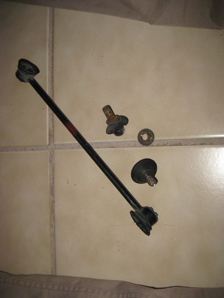

remplace the stabilizer link.

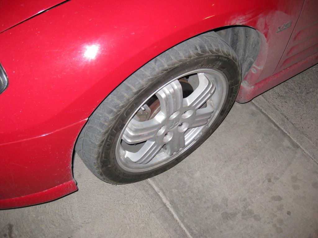

Here in mexico this is the number part left and rigth
first lift the car and retire the wheel

i recomend you change the two sides at the same time.
this is the bar hole
and the hold on the strut
so you have to reinsert the bar with the strut with the new link
i used one hammer to push the bar and match the link in the two holes
and rearm all !!!!
