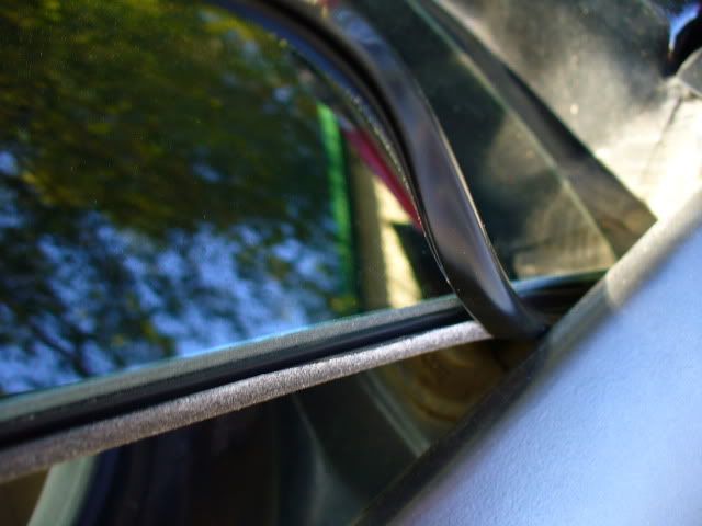

This might not bother too many owners, but for those that notice the gap between the glass and the side piller of the roof on the hatch; you will benefit and most likely enjoy the outcome.

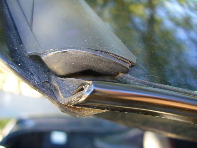

Start from the back of the glass. You will notice a piece of plastic trim, that is where you push the Edge Trim into.
Continue pushing it down until you get to the end. This is where you need to take the wire cutters to cut the Trim at the same angle (or as best as you can) as the end of the original trim.

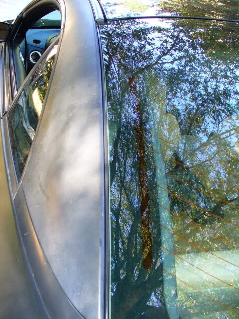

Once complete, it will fit flush with the rest of the contour of the vehicle and the annoying gap will be gone.
