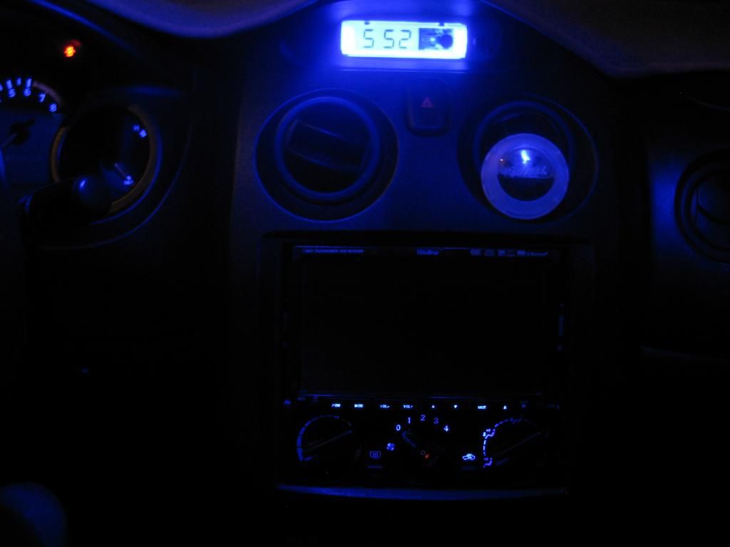

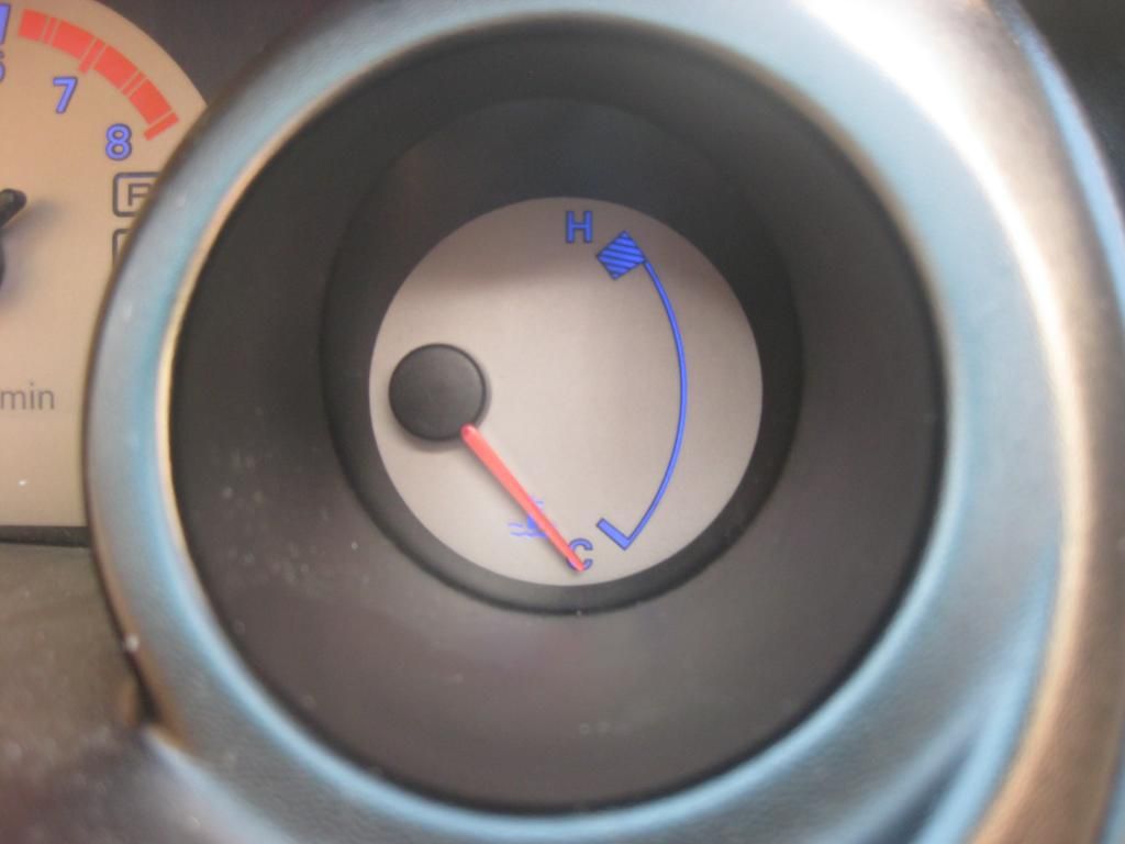

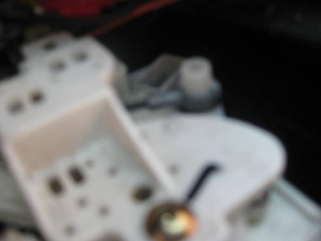

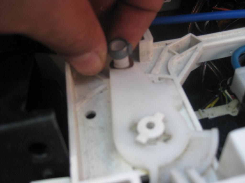

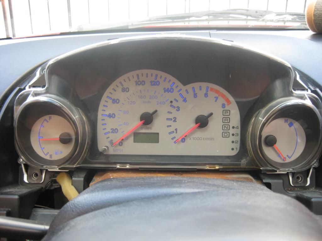

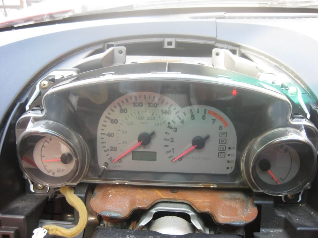

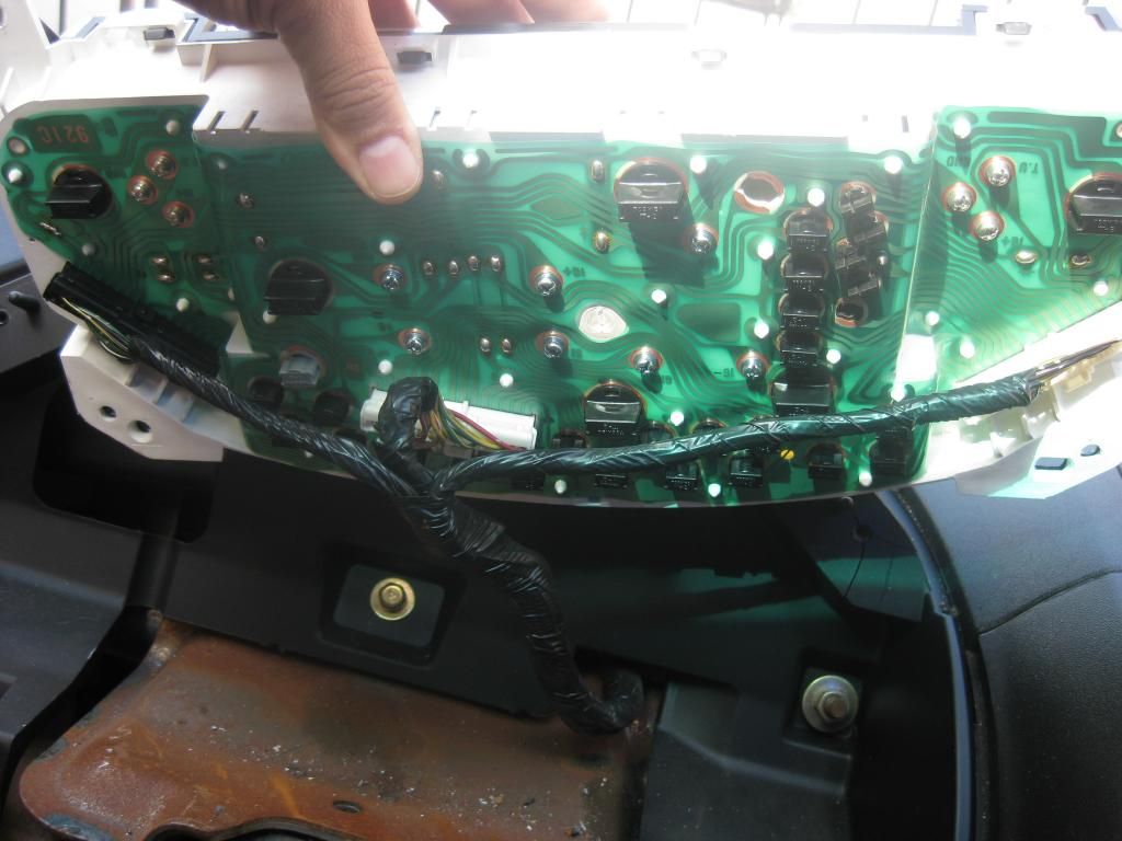

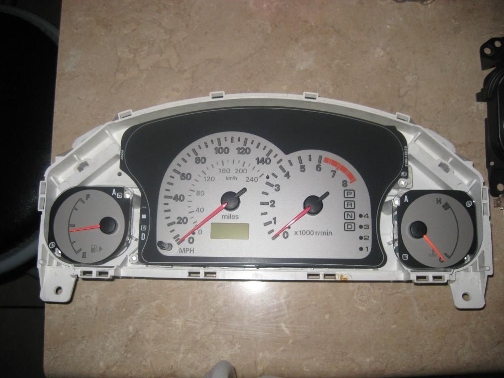

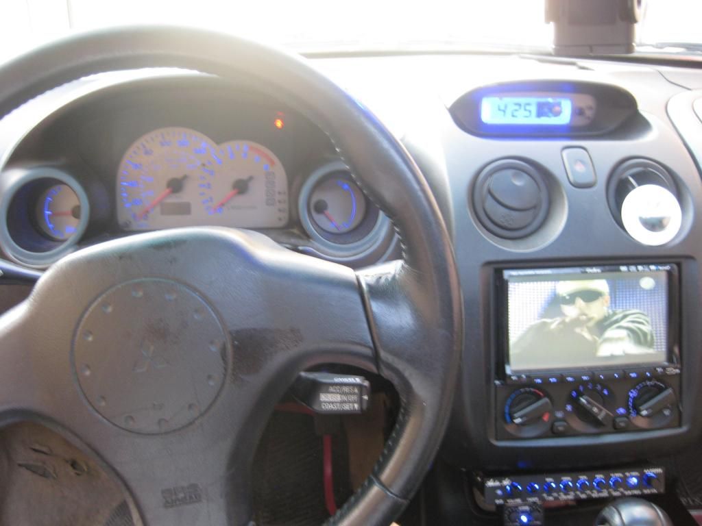

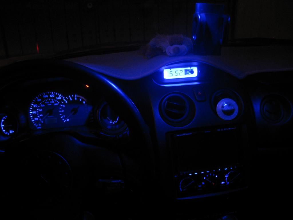

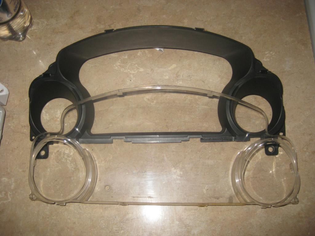

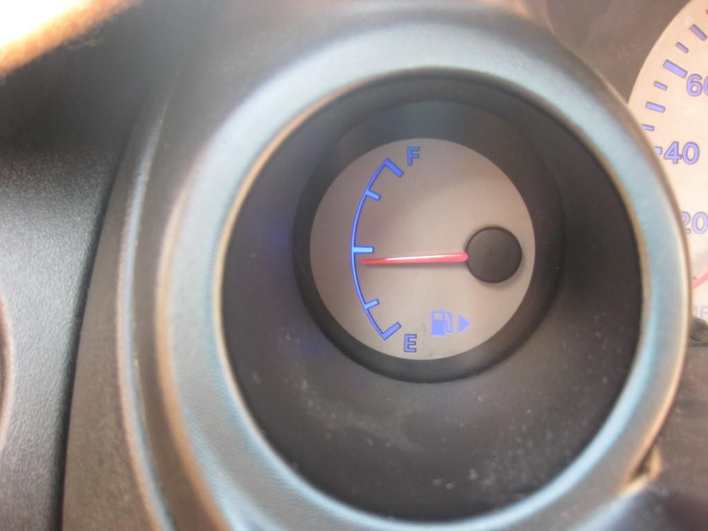

today i expend time in my 3g

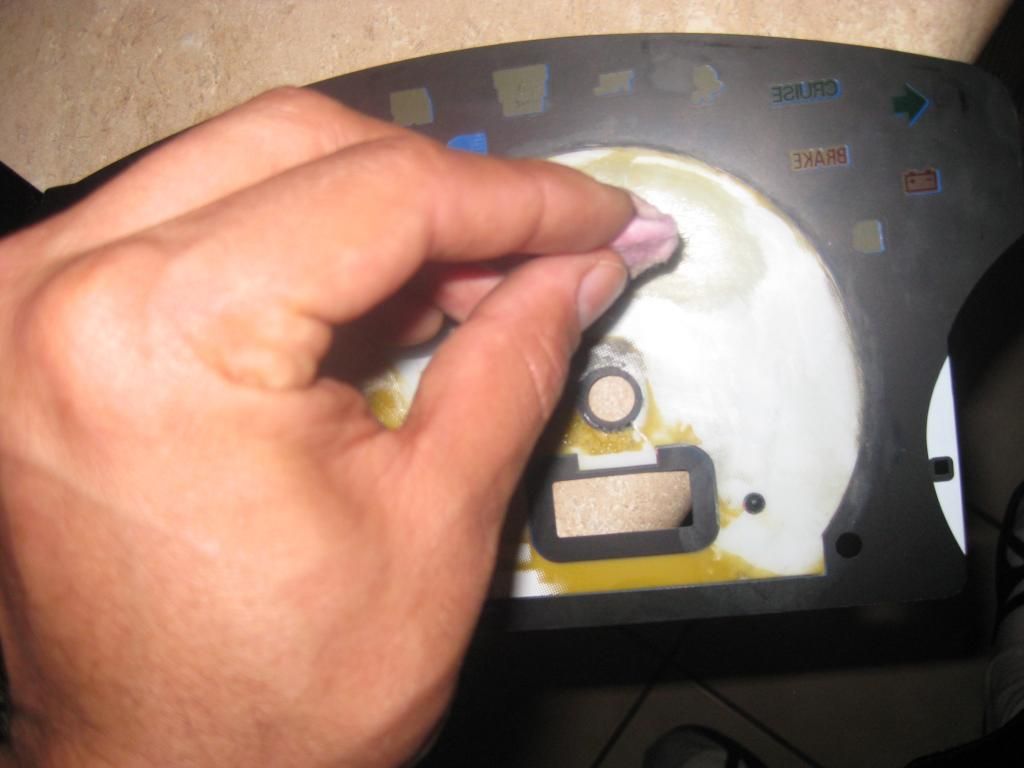

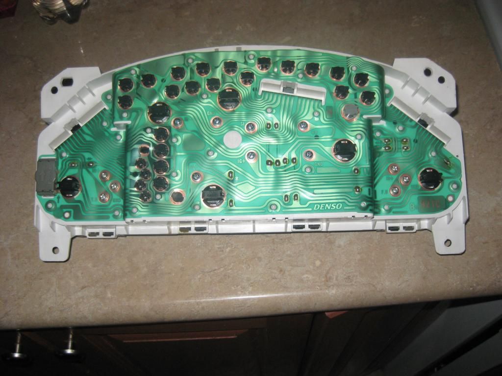

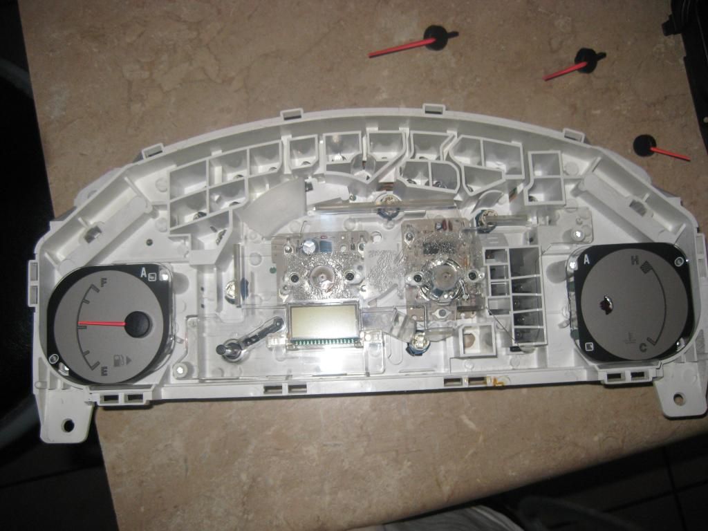

first i disassemble the gauges
then disarm the gauges

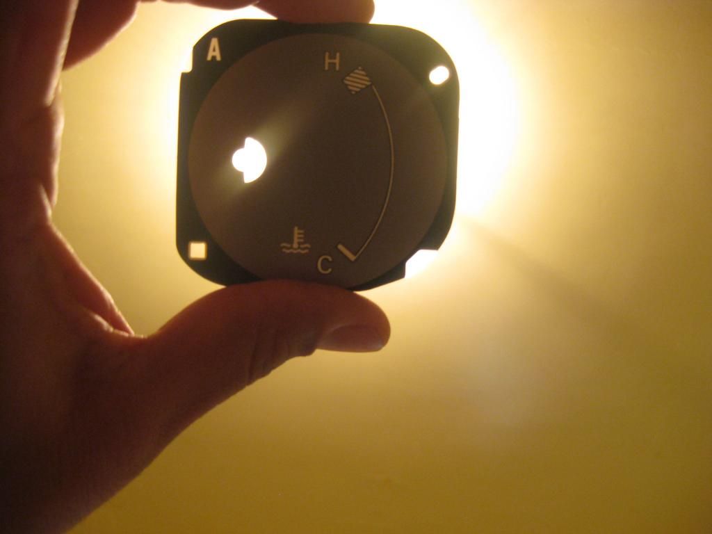

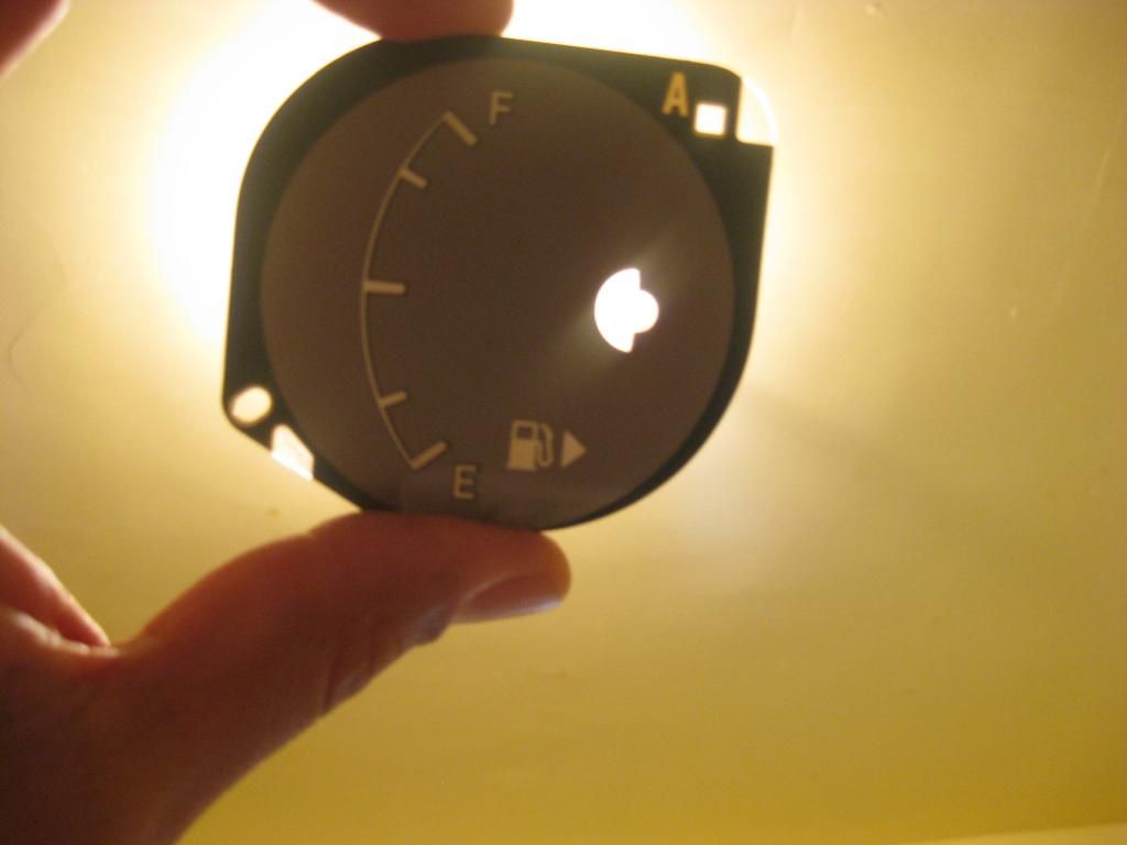

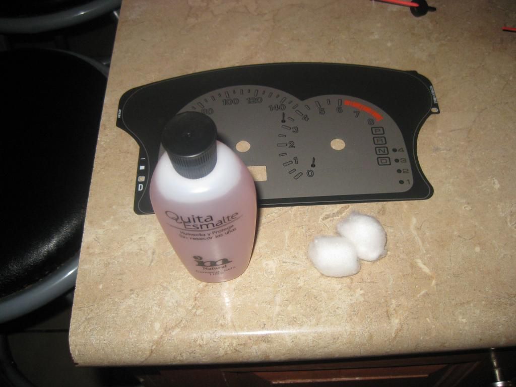

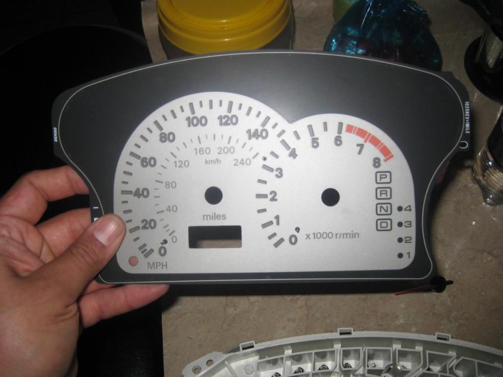

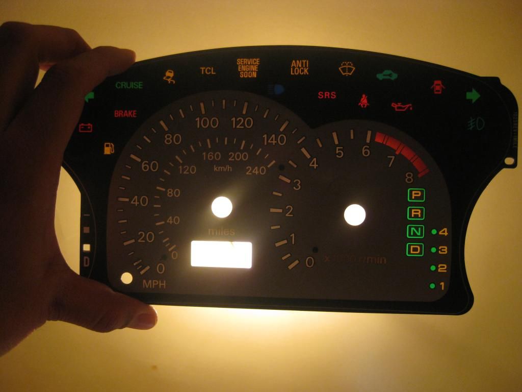

and clean the rear side whit nail polish remover
this is the result against the light

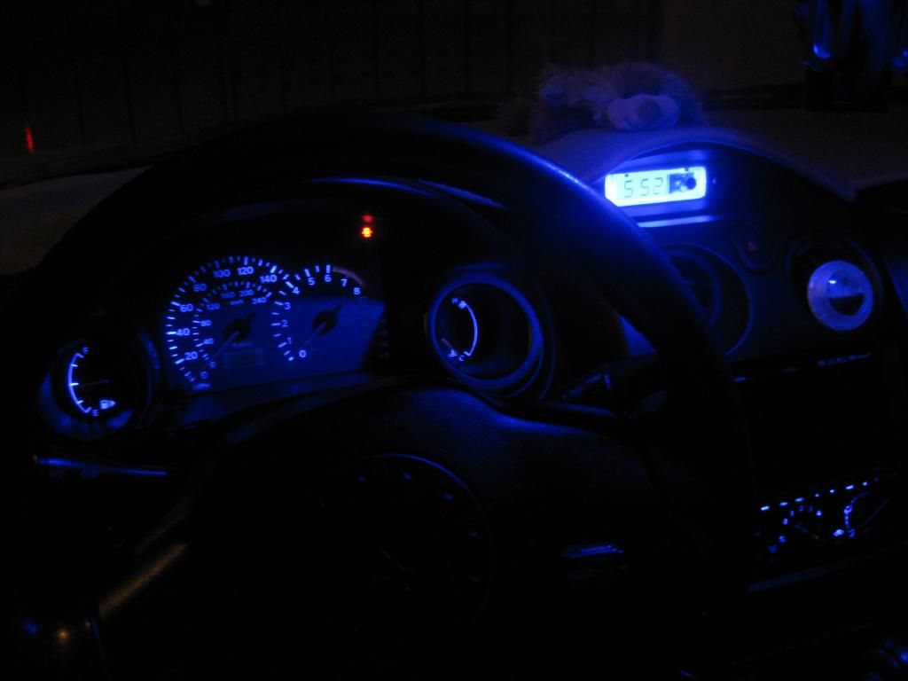

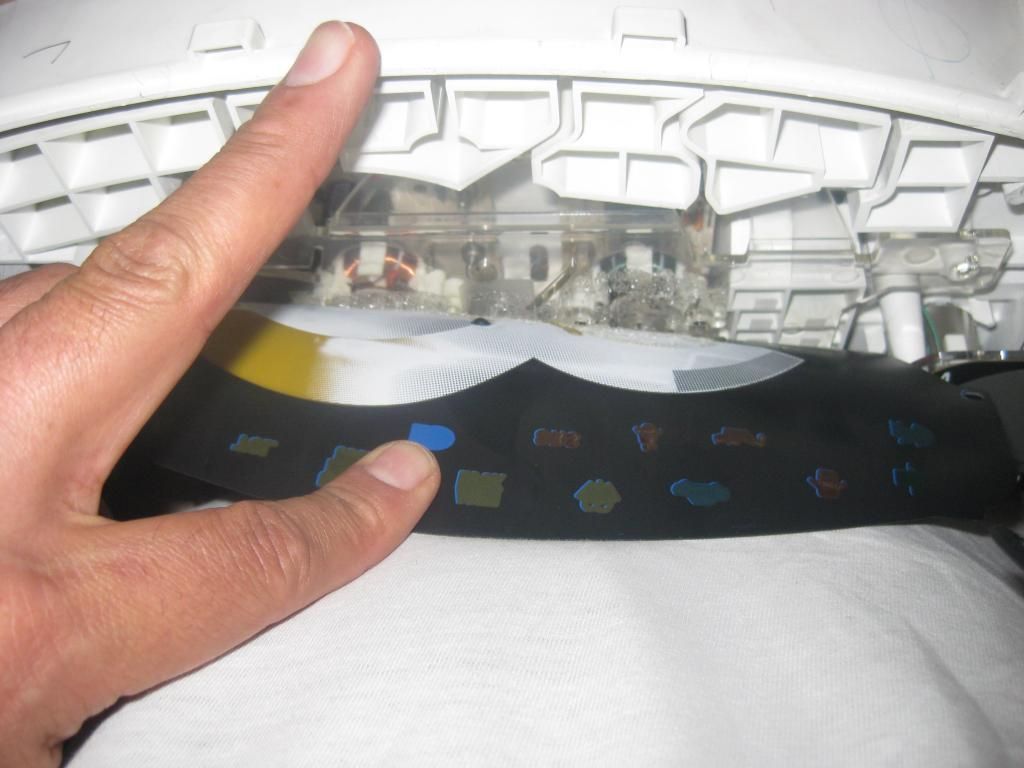

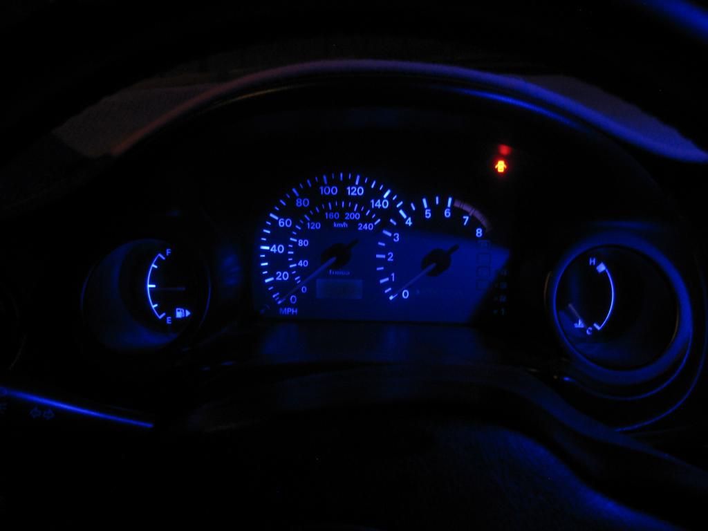

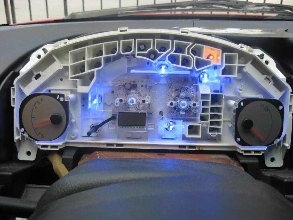

then install the led lights
and arm the gauges

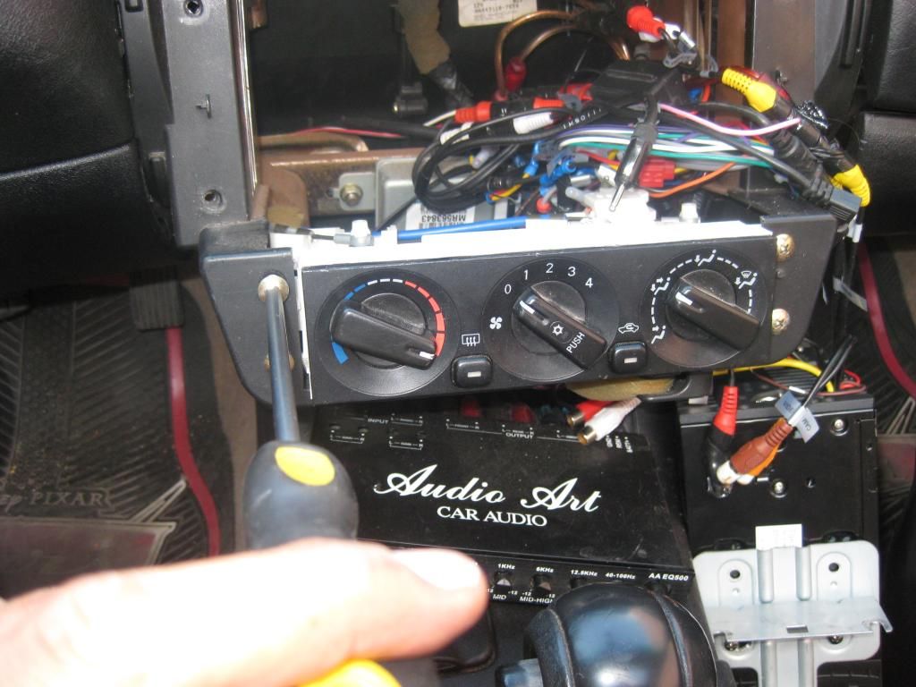

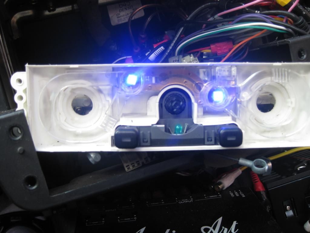

now change the lights in the air control
disarm the panel
install led lights and rearm the panel

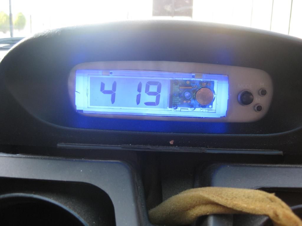

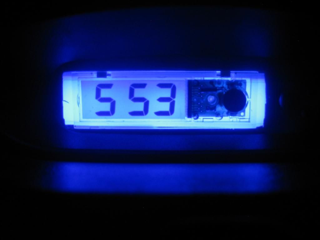

my clock doesn't work so i had to change for another and do the modifications
the results were good here some captures

Great walkthrough! I saw this after I did mine. unfortunately I didn't clean the back of the face gauges like you did. Could this be why my "superbright" leds weren't actually super bright:squint:? If so, I will be sure to do that asap.

Thanks for the walk through buddy. I almost made it through without a hitch... however my needles aren't gripping so my tachometer and speedometer aren't working. Lol advice?
