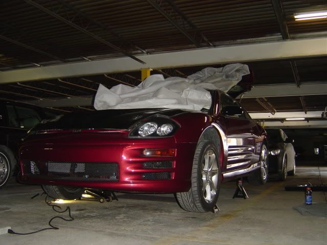

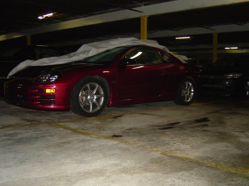

Supporting the Car & Jacking
1.) Loosen all of the lug nuts on all four wheels. Using a breaker bar/pipe for leverage makes this a lot easier.
2.) Jack the Car in all for corners in the proper jacking positions (Check Car Manual for proper positions), place a jackstand under each corner until car is supported on all 4 jackstands.
***NEVER SUPPORT THE CAR WITH JUST A JACK WHEN WORKING UNDER THE CAR!!!***
3.) Remove the loosened lug nuts then remove the wheels and put them aside.

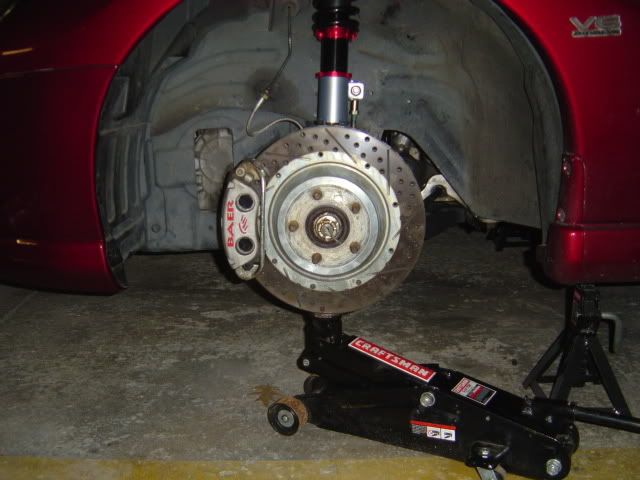

1.) Place jack under the front suspension, jack the stock suspension slightly until its firm and wont move.

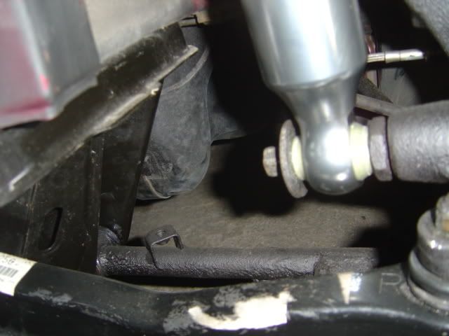

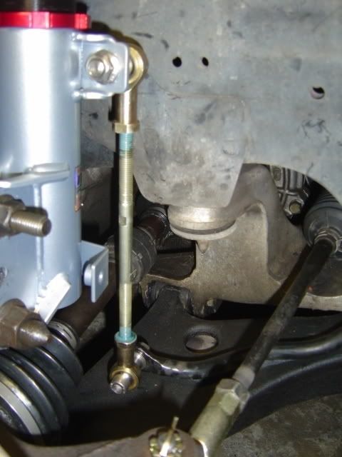

2.) Remove the stock endlinks. Spray with PB Blaster to loosen the rust. Allen wrench on the bolt end and a 14mm socket on the nut. If this doesn't work. Hacksaw or Dremel the Endlink in the middle. Then using your hand, use break the endlinks at the ball joint, by either pulling or pushing on the cut rod end. This should break off the end of the endlink that's on the ball joint. Now you can use your vice grips and put them on the ball joint end. Take your 14mm socket and a breaker bar and loosen the nut. This should work everytime.

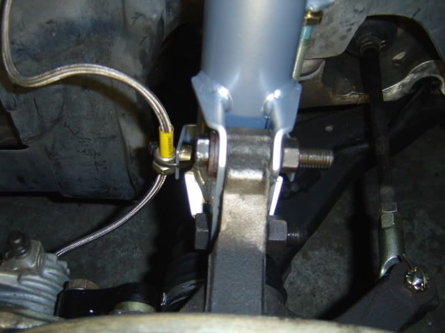

3.) Time to remove the big bolts, can't miss them. They go through the strut assembly and spindle. There should be two bolts 18mm is the top one. 24mm is the bottom one. Put the shallow 18mm socket on the bolt head end, then put the deep 18mm socket on the nut end, make sure you are using a breaker bar or a breaker bar and a extension on it to make your life easier. Take 18mm bolt out. Keep the 24mm bolt in place.

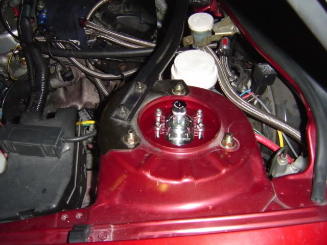

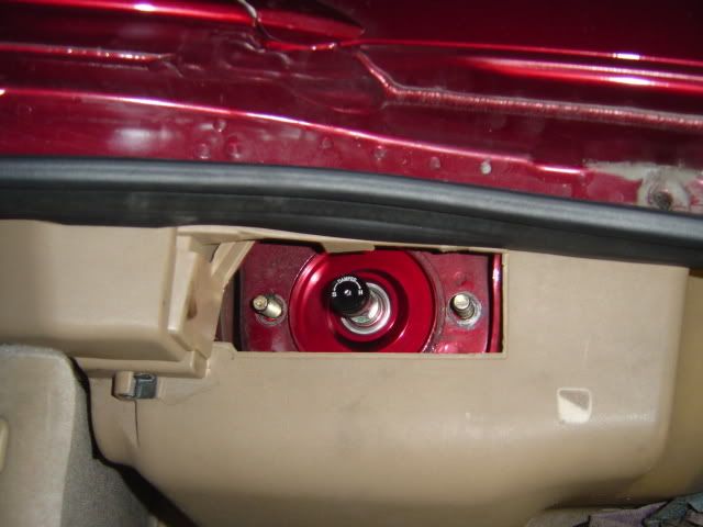

4.) Now take a look at the top of the strut there will be three 14mm nuts holding in place. Take those off.
14mm Nuts-Look gold in the photo
5.) Lower your jack down a little bit, the spindle end should glide down a little bit along with the strut assembly. Now remove the 24mm bolt and remove the entire strut assembly.
6.) Keep your jack in place.

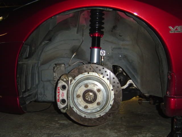

Installing Front Coilovers
1.) Make sure you still have jack under the suspension.
2.) Slide in the Megan racing coilovers onto the spindle.
3.) Install the 18mm and 24mm bolt and nut. Handtighten, if you tighten them now, making adjustments will be difficult.
4.) Install and bolt into place the endlinks.
5.) Now slowly adjust the bolts on the top plate to the car chassis holes. Slowly start to jack the suspension into place.
6.) Once it is in place, handtighten the 14mm nuts on the studs.
7.) Replace the wheels, and put on two lug nuts to hold wheel in place, tighten lightly. Lower the jack down.
***Now the suspension is installed, time for making final adjustments.***

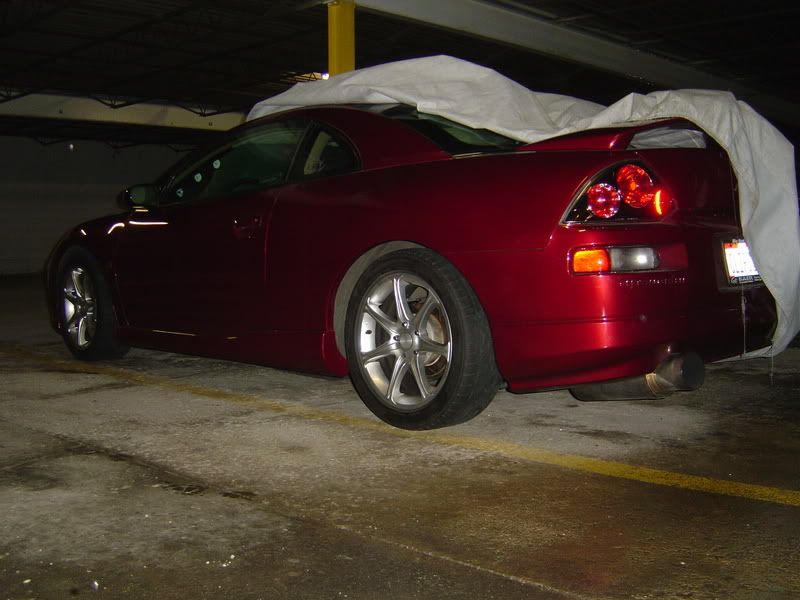

Final Product
If anyone has more pictures or better pictures feel free to PM or Email them to me.
