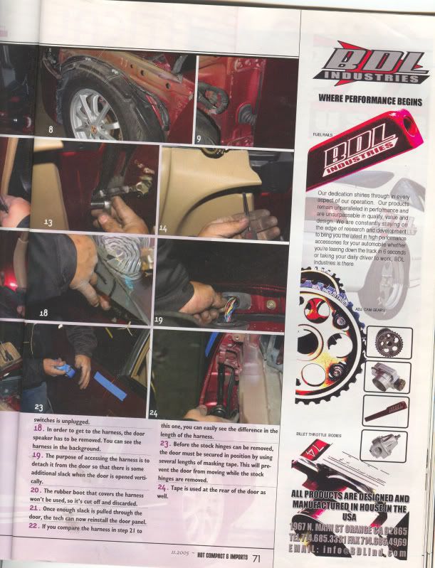

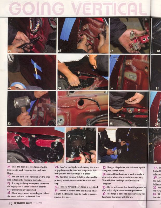

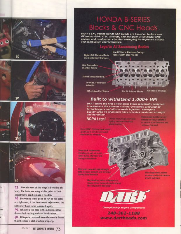

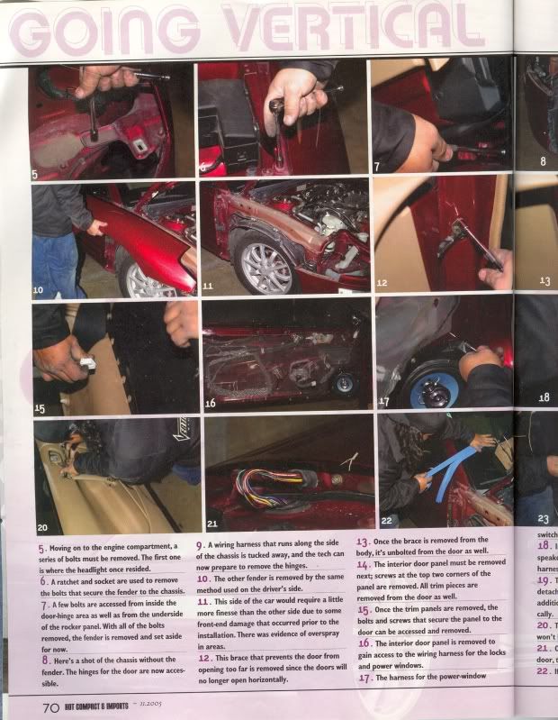

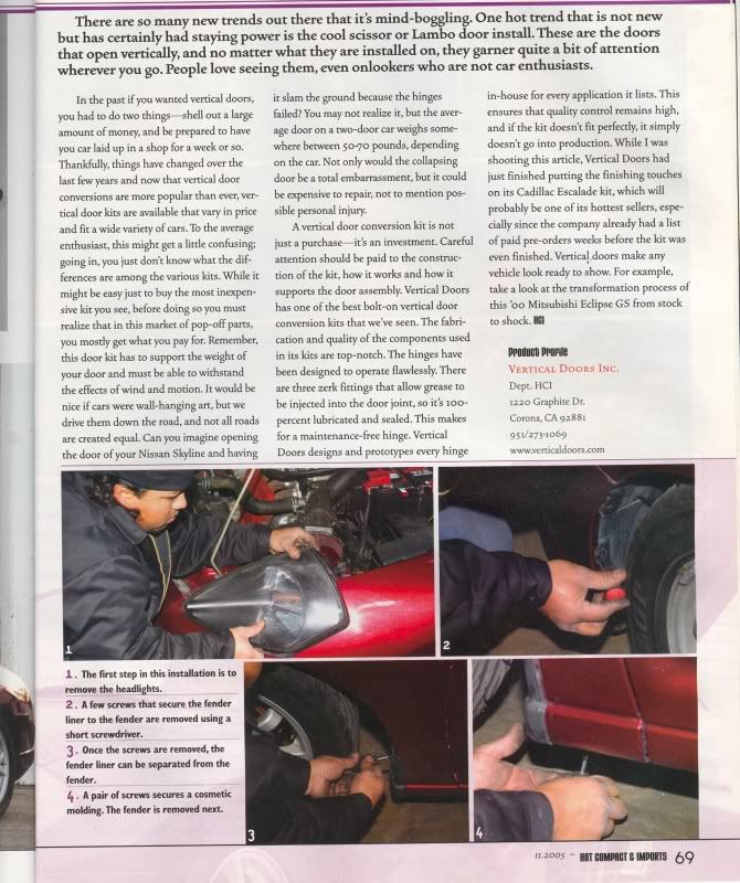

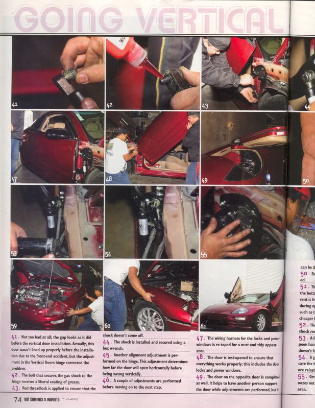

Alright so I had these high resolution pictures stored on my email for a long time. I never actually used them for my kit because I got them the day after I installed them. I wish I had them their to help at the time. I figured I'd post them up because I don't think they are displayed anywhere else on here and some people may find them very helpful. I still have the higher resolutions images if anyone is interested.
