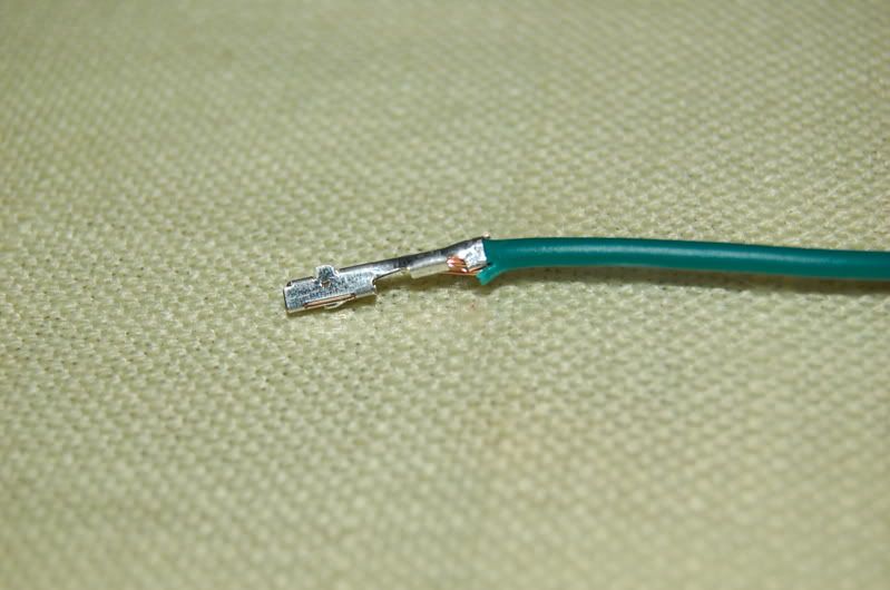

I bought the crimp connector contacts from NEWARK.com, but for some reason, I don't think they are touching the PIN on the ECU correctly, and also, one is a bigger size (the number 3 pin). With the number 11 pin, using the crimp connector works, but the pin won't go all the way inside the connector (green plastic piece)
I've never done anything like this before.. does anyone know if I'm doing this right? I'll try to take pics later on and post them to show you guys what I mean if you don't understand what I'm trying to say.. lol.

Please post pics when you get it all figured out. I bought pins and cannot get it to go into the harness far enough.
Steadly, I bought the pins as well and it still isn't going into the wire harness the way its supposed to. What a pain in the ass.. something so simple and yet it won't go in all the way.
I'm guessing thats why I'm still getting the CEL, cuz that damn crimp socket contact won't touch the PIN. ARRRRRG I've already gone through 6 or 7 of the crimp socket contacts, at this rate I'm going to have to buy more! and just for 2 pins!
Those pins look a hell of a lot like the ones I got.
Yeah I bought those pins from Newark dot com.

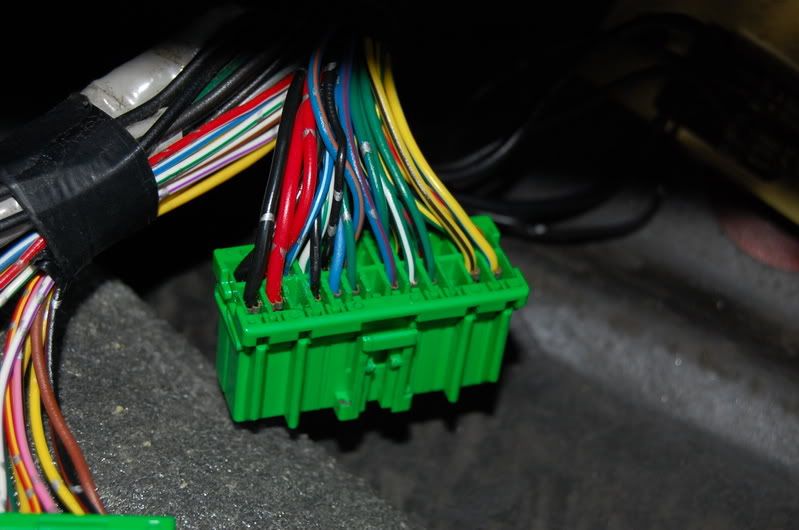

I've been trying to put that into the 3rd hole on the left (PIN 11)when looking at the picture of the wire harness (green clip), but it won't go down far enough. Am I missing something?

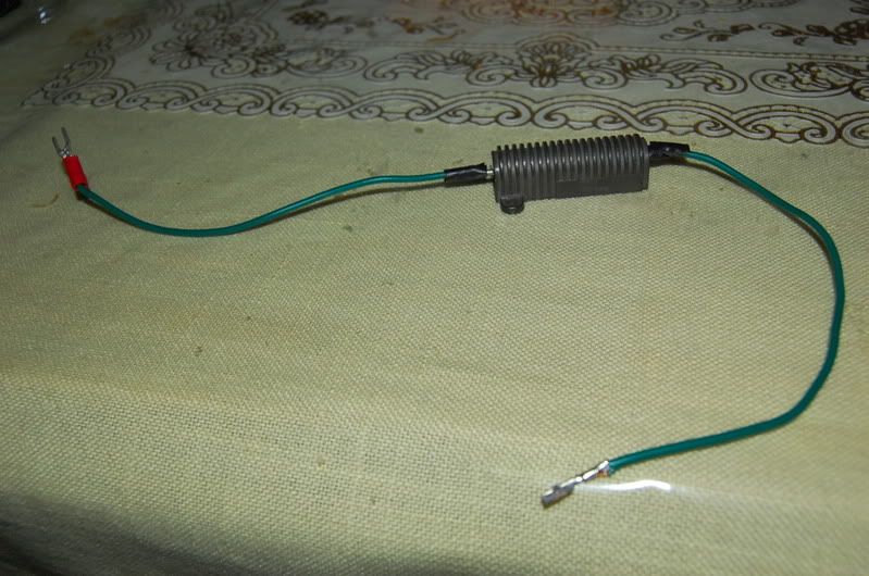

Also, the 2nd picture of the resistor, is that how its supposed to go? Ground.. Resistor...then crimp socket contact to the ECU PIN?
That crimp socket contact shown doesn't connect to PIN 3 though because its too small.

so after another 2 hours of trying to get rid of this SES light, I managed to push the crimp socket contact all the way down. I was sure that it was touching the PIN, so I go to start my car after clearing the codes, and they still showed up.
So if anyone has done this before WITH RESISTORS, not the actual boost solenoid/fuel sensor, then PLEASE tell me how you did it and with what type of resistors. Otherwise, from my experience, it doesn't work using 33 ohm 50W resistors.
