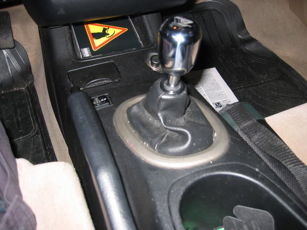

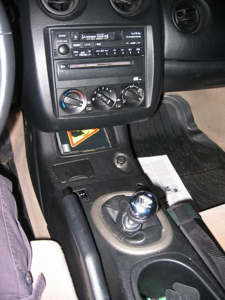

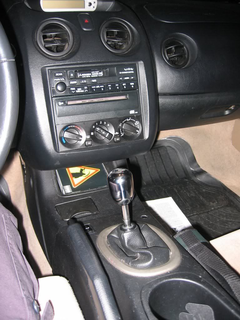

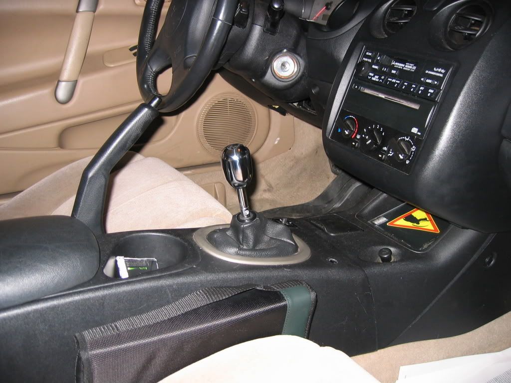

super easy install. but...lol, i forgot to install the base risers so basically my throws are exactly the same as stock. ima have to take it apart this weekend and put the risers in so then ill get to test this "45% reduction". lol. the shifter does sit really high, but i dont mind to much, it sits the same as stock but feels much better.
In first gear..
In second...
here's after i fix the boot so it doesn't sit as low.

alright. i got mine done with the 45% reduction. i had to grind away at the plastic base for enough clearance for that shifter linkage. also had to add extra risers to the rear of the base cuz the linkage was actually rubbing the car body. haha. it's all done and wow, it's sooo short. lol. i love it. it's not too short where you can't tell what gear your in, but it has a real solid throw and just the twitch of the wrist can shift the gears. haha. took about 4 hours because i had no instructions and i had to keep grinding and checkin for clearance. now that i know what i'd have to do, i say about an hour and a half. well worth it. will post pics soon
