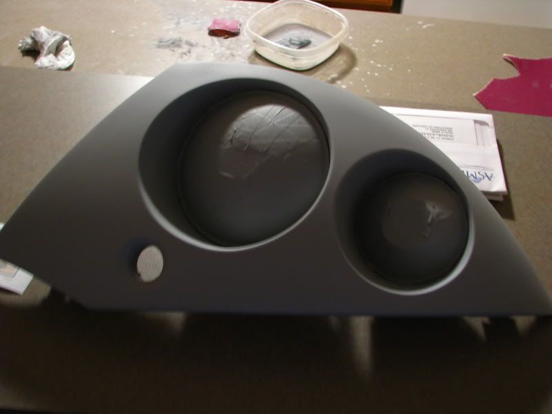

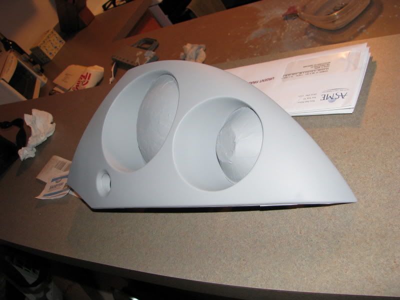

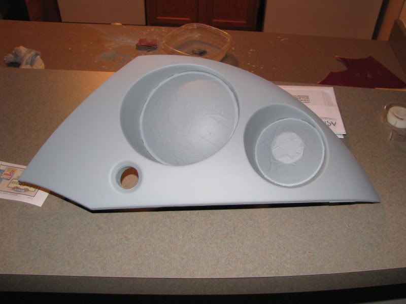

Been working on these the past few weeks. They are all ready for paint.
I have about 15 hrs into these already. Anyone interested in these, patience is the key but its worth it. Everything is smoothed out with 800 grit and its ready for paint and clear. Stay Tuned for more updates.

Did you have to break the lense completely off? Or is it still useable and able to be put back on?
No, I cut out the area of the lense I didnt need, then filled in the void between the chrome ring and the clear lense. Hand sanded down the cut out so it is smooth and the clear lense has a lip on it going into the cut out. Then I sanded down ever surface and did a series of primer, fill in the deep spots with Icing, then sand, then primer, then sand, then primer to get where I am at now. Now they just wait paint.

What exactly have you done? Just popped/baked off the lens cover, taped up the bulb areas, primered and sanded? Are you planning to mod the bulbs themselves?
No mods to the bulbs as of yet.

nicely done, i am actually been working on this very slowly and have not finished my other one yet...cant wait to see how it turns out. What did you use to fill in those little spots with to get it very smooth like that?
