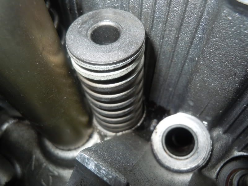

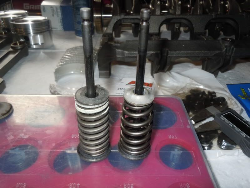

Who said the Evo springs fit our heads? They aren't even close. I bought one years ago to compare and it won't even sit in the base circle. They're wider and shorter and according to a tension measurement I read up on once they're softer than ours too.
When I talked to RPW years ago as well they told me the spring tension wasn't the issue for us (this was prior to any real headway on boosted 75's where float started coming up). It's that the stock springs bind under high lift circumstances and that's what the RPW springs have to offer is that they can compress for the required lift. They made a high PSI set and a basic set, the high psi settling in at 100 psi seat pressure. However that option was dropped last year because it was unneccessary for anything short of insane boost numbers. I've put 17 pounds through the basic springs at 7k and had no issues.

6g7x Springs in our heads with OEM retainers
Evo springs/retainers in 74 heads
Evo Spring on Left, OEM on Right
OEM 6g7x on Left, Evo on Right
6g7x Spring base
Evo Spring Base

I should also note that the FSM states a 60lbs seat pressure at installed height, RPW states their springs need to be checked for a 50-60psi spring pressure as well. I should see if we have the spring tension tool here to double check seat pressure of these springs in this other set of heads.
Well I'll be, I must've been sent the wrong spring. That's quite annoying.
Okay so the springs at least sit on the heads but what about retainers? Needless to say our retainers don't fit on the Evo springs and we have a thinner valve stem so I doubt the Evo retainers will work with our valves.
6g7x Valve Stem OD 5.88mm, Evo Retainer ID 6.53mm
That doesn't address my question. The Evo has a 6.5mm stem, ours is 6. You need to see if the eclipse locks on the eclipse valve fit the evo retainer the same way the evo valve and locks do.
Parts #'s mean nothing to me if there are no words to label them. Why don't you quite beating around the bush and actually prove something.
Valve locks don't just jam into a retainer. They have to fit the valve and retainer like a glove. Evo locks will not fit our valves because our valves have a smaller stem. On the same note I have a hard time believing that our locks and Evo locks share the same external dimensions in which case we needs springs that fit our retainers. Based solely on imagery our retainers aren't going to sit on top of the Evo springs because they're tapered.
The requirement becomes either custom springs or custom retainers. I'd rather buy custom springs rather than evo springs and custom retainers, it'd be cheaper and easier. Though at this point you might as well order RPW because that will ultimately be cheapest.
