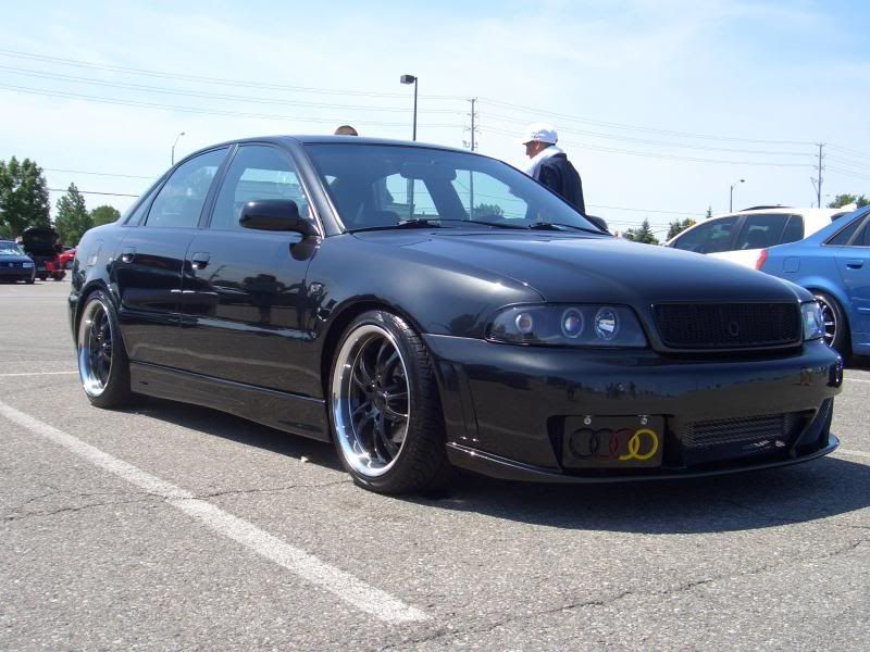

loooks good on the audi but i dont know how well it will on the eclipse man. Im just giving you a honest opinion. Shits going to look retarded with a gay offset and a tire that looks like a small condom that you should be using a magnum :) . I know tires and i know alittle bit about wheel offsets. Currently working at NTB so its my job to. Get them and if you dont like them sell them like usual. Im just trying to help you find a rim that you will never want to replace so quickly again.
If you want me to lie to you so you can get them then i will and tell you they look great. LIke the guy posted above. Your going to have to drop to a 35 series tire to get the width correct. THats ALOT more money.
