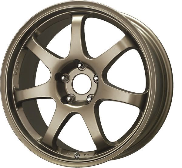

Just got a quick question. You think these wheels would be good for auto x. They are 17x8 and weigh only 17lbs and i am wrapping them in nitto neogen zr's. Just let me know what you guys think. :twothumb:
Oh and let me know wich rim color would look better i cant decide. Heres my car.

In terms of color, i would get the 2nd set. Im not a fan of gold on white.
Yea, thats kinda what i was thinking since i got the blacked out corners and all. I had bought the evo bbs mr ones but the guy backed out on the shipping these are basically the same size wise but i think 2-3 pounds lighter. So i guess I WIN.

Wheels look good, youll be in SM so I would go for some nice Kumho V710s or some sort of Hoosier.

go with a smaller set of wheels for auto-x such as a 16"

umm... unsprung weight, rotational mass, basically the smaller diameter and weight the faster...

I understand the rotational mass thing, but you can get very nice light weight cheap wheels in 17" and 18" styles. I believe my wheel/tire combo is around 38 lbs (Kosei K-1/Azenis). Also when you run a smaller wheel it changes your shift points. You have a lot smaller of a diameter spinning, therefore instead of maxing out your 1st gear at 38-40mph, it might be 34-36, which could be good on a big course because you can stay in 2nd longer, but for a smaller course it would stink, because you would be constently shifting from 1st to 2nd to 1st, which can take away from briskly maneuvering thru the course.
IMO I would stick with 17" wheels and get something fairly wide so one can have a bigger contact patch when racing.

There are soo many better choices for just as cheap. And Id only get 17x7.5 thats what I have and I run a 245/45 r17. Keep the weight down, thats the name of the game.

Im a HUGE fan of Fuzion ZRi. They have a stiff side wall, wear great, great traction, and are VERY cheap!

With a turbo'd car I don't think acceleration is going to be a problem, but traction is going to be a problem. I can't think of any reason to limit him to a 6" wide wheel, particularly since he's going to be in Street Mod, where there are no wheel size restrictions.
With that said, he could probably learn a lot about throttle control and "slow in, fast out" by sticking with the smaller wheels and tires for now, then put good sticky tires on the 17" wheels once he's got some driving experience.
for SCCA, you will be in SM /Street Modified/ if i'm not mistaken. And the width of the wheel should be fine at 6" since you can mount 225/235 wide tires on 6" wide wheels!!!
Running that wide a tire on a 6" wide wheel is a waste, unless you have to do it for Stock class rules. Since he's most certainly not going to be in Stock class, there's just no reason to run a stock wheel. He could run a 245/40-17 on those 17x8"s and have a much better contact patch and better turn-in response.

Well, OK, there's one reason. Smaller wheels/tires are generally cheaper, which is always nice.

From the sound of it he's a complete novice, so jumping straight to R-compounds would be a bad idea. All that lateral grip will just allow him to learn poor driving habits.

I think people tend to overemphasize the whole rotating mass thing. IMO, for the vast majority of "amateur" auto-xers (as opposed to the hard core Nationals types), the benefits of running a wider tire on the bigger wheel will outweigh the small loss of performance that comes about from the increased rotating mass. In other words, pulling imaginary numbers out of my ass, going from a 205 or maybe 225 section width on the stock wheels to a 245 on the wider wheels will gain him 2sec on a 60sec course, while the added weight of going from the 16" setup to the 17" setup costs him 0.5sec.
The hard core Nationals type competitor will go for the best of both worlds with custom-made CCWs or Kodiaks or whatever that are 16x9", weigh less than the stock wheels, and allow them to run a 245 in a lighter combo so they get the gain from the wider tire and don't lose out because of weight. But we're not talking about a hard core Nationals type here, so all that's a bit overboard.
If you're on a course that requires you to shift from 1st to 2nd to 1st a lot, you need to stop running with the Miata Club! :lol: Seriously, whether you're driving a torquey V6 GT/GTS or a turbo 4 like the OP, you shouldn't be in 1st gear unless you encounter a reeeeeallly tight corner on course. The car's got enough torque to pull itself out of the hole in 2nd, so downshifting to 1st is just wasting time. Shorter tires isn't going to change that.

I agree that the Nittos are not the tire to choose in that price range. I don't agree on the wheel or tire sizing, though. A 17x8" wheel will have hardly any weight penalty compared to the same wheel in a 17x7.5" - the difference would be small enough that you'd have to be a top level racer to notice it. And I think a 245/45 is too tall - a 245/40 is a better choice. Closer to the stock diameter, more wheel well clearance, and better effective gearing.

In the short term it's probably not a bad idea to learn on the stock wheels with some relatively inexpensive tires. If you do that, I would stick with the stock size (205/55-16), because there's little to be gained by squeezing a wider tire onto such narrow wheels. You'll have a flatter contact patch and better turn-in response by sticking with properly sized tires. In that size, I'd look at the Kumho ECSTA SPT or Fuzion ZRi, which are $77/78 each on Tire Rack. The next step up would be the Hankook RS2 or Kumho MX, both $91 each. At this point, I wouldn't bother going any more "hard core" than that, because you're just not going to be a good enough driver to extract the performance from better tires.
