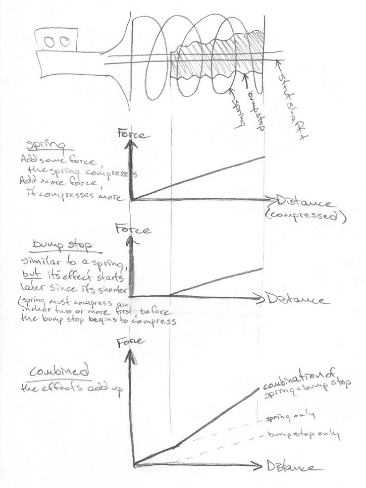

That's a big statement on this. Here's the options as I see them:
1) Replace the 3/4" worth of bump stop with something a lot more substantial. A new one is 4" or 5" tall or so. I don't remember exactly, but it's a decent size, way more than 3/4". This will actually give you the protection that you want, that large piece of foam is actually pretty hard and is partially designed to protect the car.
2) Maybe turn up the AGX's another notch. They stiffen the compression and rebound at the same time, and stiffening the compression a notch may help as well.
What's happening right now is that your springs are coil binding. Once they are stacked, you have nothing left to absorb a bump and you get the slams. You need more "stuff" in there to keep that from happening. A stiffer strut will help, a large piece of foam rubber (aka bumpstop) will as well.
Unfortunately it's got to come apart, and you'll have to buy 4 new bump stops too. When those go in, don't cut too much off. My rule of thumb (take it or leave it) is if you lower the car an inch, cut off an inch. If you lower it 2", cut off 2". And so on.
Once it's pulled apart, you'll know if the strut is good or dead. A good strut will be hard to push in, and will push itself right back out. A dead one won't do that at all, it'll either slide in and out easily, or just drop in and not even try to come back out.

Hopefully this makes some sense of bump stops and etc. relating to protecting the car:

first off +1 for some really good info right there. Secondly, I went under the car last night to check out exactly how much bump stop is there, because I haven't really payed attention to it since I gave everything to the shop to put on. Here's what I found .....
In the front: Stock bump stop cut down to about 3/4 - 1 inch. It was so small that from impact it was actually pressed all the way into the top mount. Meaning I pretty much had NO bump stop in the front.
In the rear: IDk how much bump stop was actually cut, but it was so small it was actually pressed so far up into the mount I won't be able to pry it out untill I actually take the assembly apart!
So i think i finally have a cause to all my problems .. No bump stops! I'm going to check this out this weekend and see how it affects my ride. Right now my setting are on a 2 in the front and 3 on the back for daily driver use. Anyone feel i should go stiffer or that is good for a DD?
Also I will be trying to cut the stops as you said Tracer, w/ the springs I have I'll try taking off 1.5". Again, thanks for all the info.
