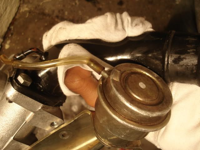

thanks for the info guys i will try it out as soon as i get a chance, might not be till wednesday. Ithinkyou how did you get your j-pipe on and if that is a evo 8 16g then where is your waste gate and did you have to modify it. the reason i ask is because my j-pipe is either hiting the wastegate or the cross member
1,888 Posts
that pics from my fitment test so i didnt attach the WG yet but is fits fine though. Its the stock evo jpipe for the turbo. I did have to clock it just a bit after grining the lower water hose screw location but since im using that hose it still fits. You should show pics although it could be attributed to how your setups manifold and whaterver else is positioning the turbo. Mine sits pretty good.

oh!! your jpipe hits cuz of the way youre tryin to put it on. I did mine the opposite direction. Actually after looking at it, i think the nipple is on the wrong side. Because the one on mine sits in that same spot but the pipe curves in the opposite direction of yours.
wierd, got mine from slowboyracing made should have gone to the dealership, but it shouldnt matter now cause im pretty much set on making my own piping so i will cut it up a bit.
1,888 Posts
Here we go. I think i put the jpip on 1st and then the WG 2nd. I was planning on clocking the cold side a bit so i think thats how i got it to fit. Just run the appropriate vac hose and "T" between the two.:D
110 Posts
Discussion Starter #18
cool thanks, looks like your wastegate is held by only one bolt ill try if it works out for me
