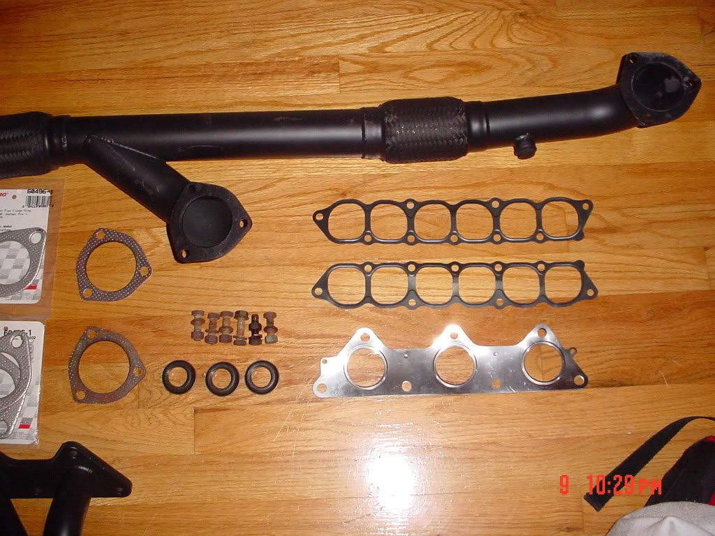

Since i bought my CMF Headers used, i am trying to install them tommorrow but first i need to make sure i have everything. So please all i ask is for your help. Take a look at my posted pictures and let me know if i am missing something. I need to know now, so tommorrow morning i can run to autozone and pick up something i missed early saturday. Thanks alot!

Why do you have intake manifold gaskets?
idky, but those look like painted Meagan headers!!
Only needs one. I assume he will have the plenum removed in order to access the rear mounting nuts :dunno: I see he has spark plug tube seals as well... should not be needed unless your sparks are getting oil on them or unless you already have the valve cover off.

Eventhough there is a cat on there, there is no bungs after the cat for your secondary o2 sensors. They are the ones with the grey clips. You will either have to locate your secondary 02 bungs behind the cat or buy spark plug non foulers and follow the how to in order to not throw the code.
Oh and you dont have an egr hookup so you have to follow the how to about making an ERG breather that way that code doesnt show up. Good luck. You should get some pb blaster or somting like that to lube up the nuts and bolts that will not budge.
