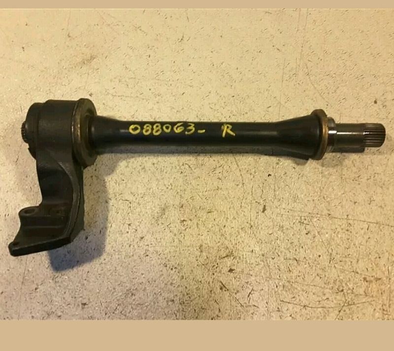

I'm working on replacing my Axels, the Left (driver) side was simple, and I'm fighting with the Right (passenger) side. When I opened the box I picked up from the Auto Parts Store, I'm thinking the wrong part is in the box. Can anyone confirm this is the correct Right (Passenger) side axle for a 2000 Mitsubishi Eclipse GT? I was under the impression one side should be female, and the other side should be male.

I was under the impression the outer axle (the one I have) where the Tripod Joint is, is supposed to be female, and I would put a new c-clip on the inner axle that comes through the support bracket, and slide the tripod joint onto the inner axle at the support bracket shown here in the photo.
I guess I answered my own question. Thanks for posting the photo of the inner axle on the support bracket.
