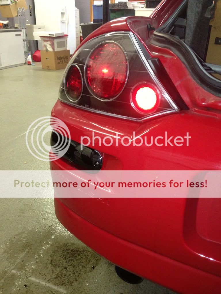

Sonar tail lights
Smoked rear corners W red LED's

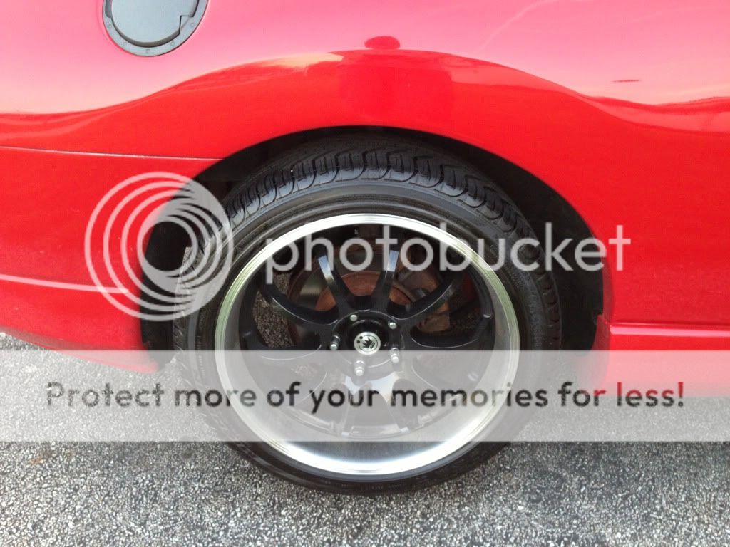

xxr wheels

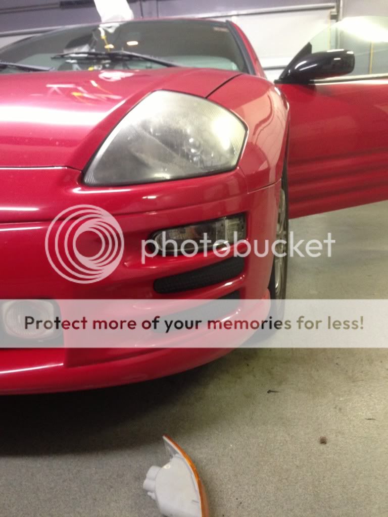

Tinted front corners

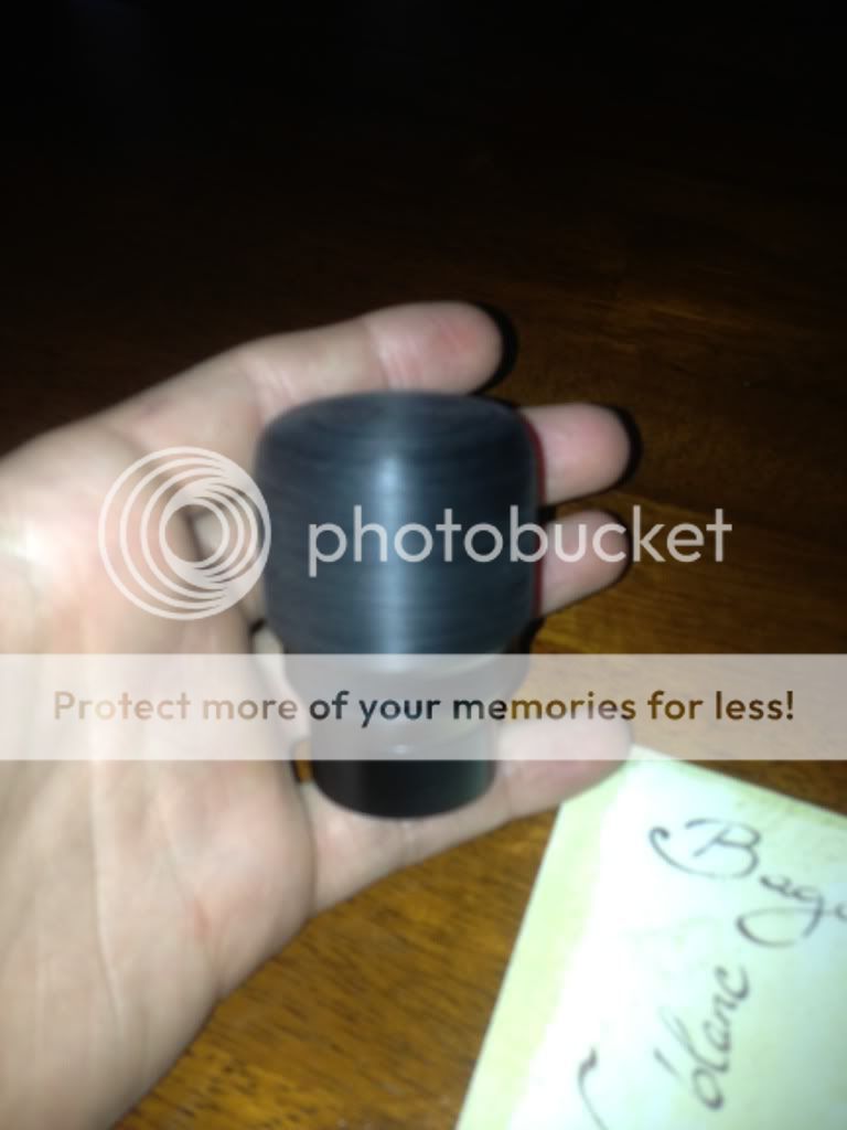

Black Delrin knob

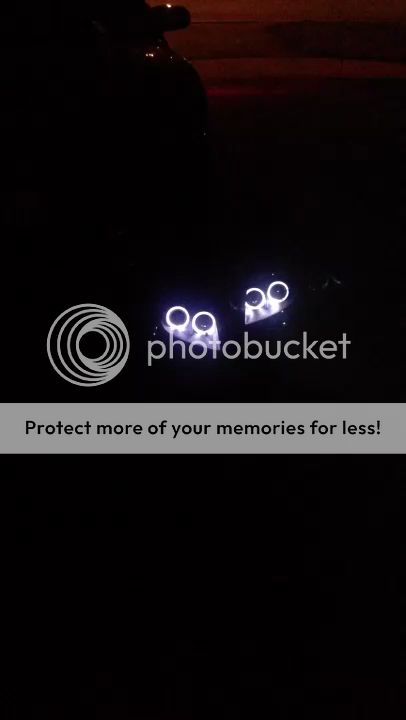

retrofit headlights-6000K HID's

The tails ARE sonar, I had to double check myself. The post was made in the middle of class the other night.

Just picked up the 03-05 door panels and this ties into the black delrin shift knob. (the plan)- the strip accent that is commonly cf wrapped will be wood grain along with the shift knob. Ive come from a wood working background and thats what i want ( big leaf maple burl ) then i will wrap the midnight blue in most likely silver suede and ill make the shift boot match.
