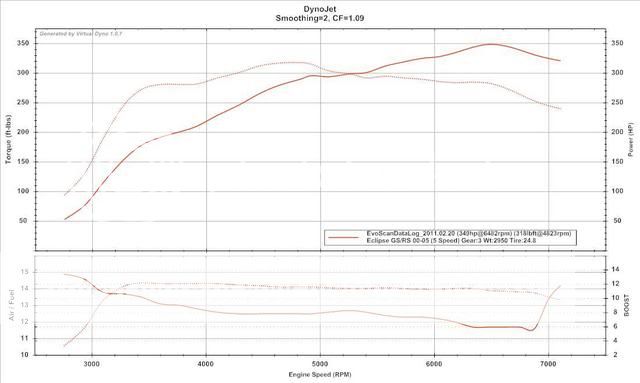

Did some tuning on 93oct, im at 351whp at 12psi on a evo8 9.8hs 16g turbo:ndance: Also this is with a smoothing of 1, this shit pulls super clean. I put smoothing to 2 and it was to smooth lmao.
Im not even done yet, but im gonna leave it conservitive for now an turn up the boost.

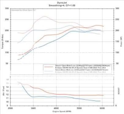

First Customer Smed112233, he came to me with a tune from a local shop which had alot of knock and was overall horrible. He made 200whp on their dyno, when I ran his base pull threw VD it showed 202whp so its very close. He fixed some boost leaks which raised the wastegate pressure from 10~psi to a 12psi spike, with nothing else changed he was making 206whp. Also if you dont know Smed has an Auto RS, which means no Sporty. Which is a big issue when tuning because you cant do full 3rd or 4th gear pulls. Anyways at the same wastegate pressure he is now making 224whp. Not bad considering he is getting robbed an extra 10%hp to the wheels over a manual from the auto tranny.
Please ignor the tq readings as anything before 4000~rpm isnt WOT because the car would downshift. And sense its P-T you cant compair from pull to pull.

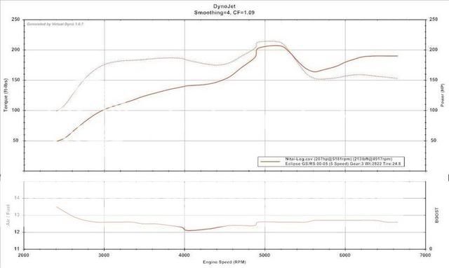

This is Nitai3g Base Dyno sheet
Results coming soon, his clutch started slipping as soon as we started tuning.
