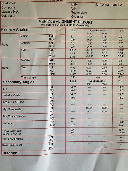

To elaborate on the preload mistake I made in following the garage thread. I only got to the rear suspension with the time I had and not yet performed this disaster on the front. Due to schedule constraints once I realized I made a monumental mistake I had to wait about 200 miles before I could get the coils set back to where I had them. In that short period of time I COMPLETELY wore off the entire thread from both rear tires. I put 12,000 miles on the tires in the last year and they were about half worn down to the wear bars. In 200 miles I ground them the rest of the way down to nearly completely flat....
What a disaster this has turned into... Hopefully now that I have reset the preload and got the wheels as straight as I can the tires will last to Saturday and I can get another alignment...

I think it must have had more to do with the fact that the tire was not contacting the road correctly and skipping on the pavement due to the very accelerated wear.
I could be wrong but I don't think that compressing the spring and then extending the threaded height adjustment would have changed the alignment as there was no height change. I got it aligned for the lowered height already so compressing the spring and screwing out the height adjuster should have produced nearly the same wheel profile I started with.
At least to the degree that I would have gotten more than 200 miles from it. Something is way off to develop that kind of wear.
An alignment will happen either way at this point, but damn what a terrible experience. This is one case where I should have left well enough alone...
#21 ·
You shouldn't ever do any major suspension work without planning on getting an alignment if you have to take apart anything involved with the cars alignment. There are some things that should go back together without changing alignment, but from my experience should doesn't mean will, and by that I mean it never works for me, haha.
I reset alignment for even the most minor changes, its just not worth trashing a set of tires because you where being cheap.
