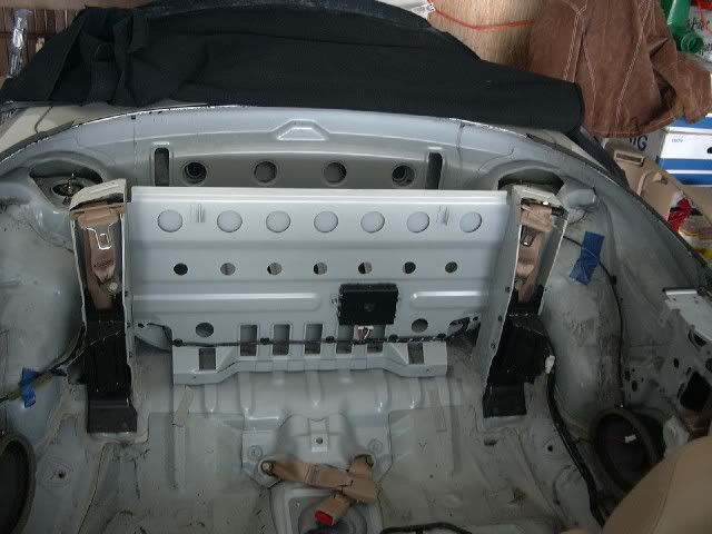

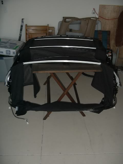

It is quite simple, if you have more than 3 days to work on this and have the out most patience, then why not do it your self. Tearstone knows I'm a full blown stubborn DIY and so far I've been blessed with good results. But you can not do this yourself by your self. You need to get the unit out of the car and that thing is pretty heavy. Also there is a bar that goes from one side to the other that holds the canvas to the metal of the car. It is super tight in place by one screw on each side. To take that bar out, you need patience and some ingenuity because otherwise you will damage your side rear mirrors(scrashing them with the bar, by accident) and the odds of that are pretty high.
Remove everything out:
Stripped unit sitting on the table with the bar hanging from it:

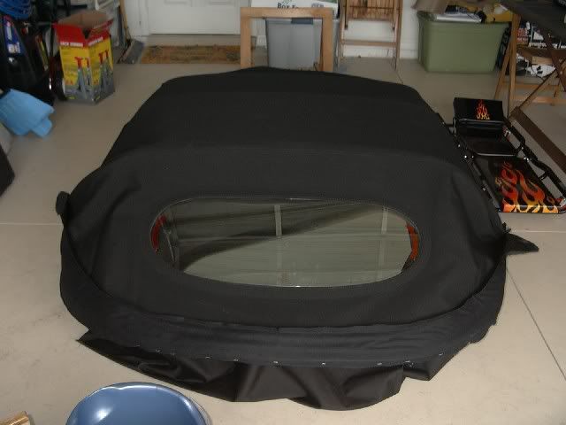

5 hours later, after removing and putting staples over and over again to make sure it was aligned (the center of the mirror) and that the canvas stretched into a smooth even surface with no winkles(which was one hell of a task to do). I installed and removed the unit more than 10 times to make sure the mirror was in the center and there was no rinkles.
I'm not trying to scare you but just to show you a "little" of what is to come if you decide to DIY ;)
