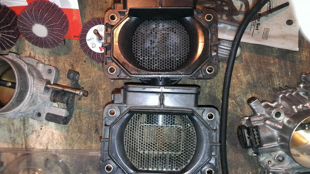

3g's came with two different MAF's throughout their production. The first and by far most common is the 501 MAF sensor.
This sensor came on all GS's, RS's, and GT's over all years.
The other sensor is the 482.
This came on all GTS's, automatic and manual. It also came in some Montero Sports.
Notice the differences, 501 top, 482 bottom.
The 482 is geometrically identical to the 399 MAF that comes on the Evo. It however has different scalings. To my knowledge it has the same air metering capabilities, I have mine out close to 550 at the crank and I haven't topped it out yet. It provides a HUGE improvement in response and flow over the 501.
The 501 however is a different story. Of a few cars I've tuned and worked both suck through boosted and the big block naturally aspirated the 501 has failed to perform. It's as if it can't keep up with the air flow in these applications and had to be swapped out for the 482.
I've run into a number of tuning problems with both MAF's ultimately. Refer to the 5 key points I mentioned at the beginning of the post, unless all 5 are satisfied you will have to compensate in the tune for inaccuracy. The MAF's come attached directly to a straight flow air box providing for the flow requirements, the problem is when you upgrade to aftermarket intakes and upgrade engines a few things begin happening.
The first thing to note is that YOU CANNOT USE OILED AIR FILTERS WITH THESE MASS AIR SENSORS. The oil coats the filament and their metering abilities are eliminated. You can't clean these sensors either because the elements are coated with a special film that MAF cleaners dissolve.
Secondly, open filament air filters have a tendency to spin the air as it goes through the filter into an intake tube. The honey comb in the MAF helps take care of this, so that is not deletable.

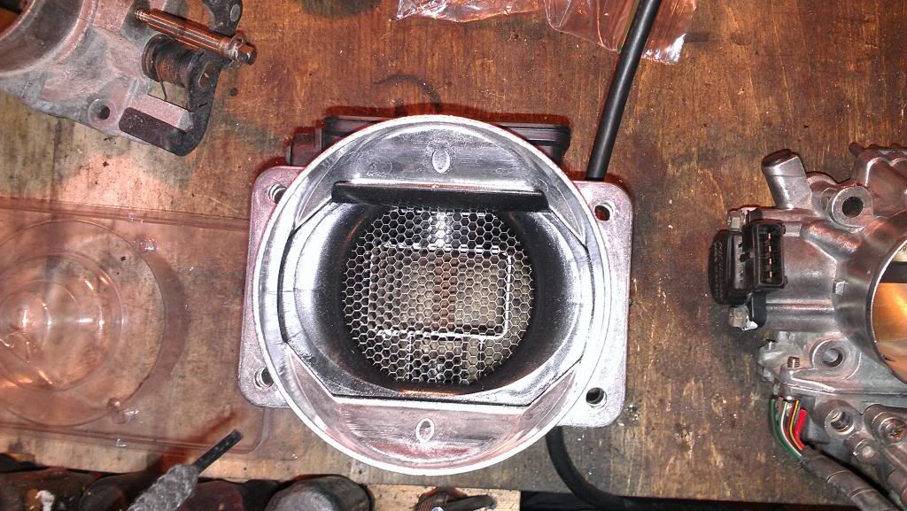

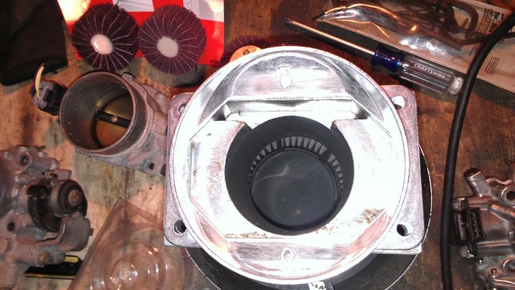

The next problem, and most common results from installing just about any aftermarket intake. Here is a comparison between the MAF plate that comes in any AEM intake and a 4.5" plate that I bought off ebay.
The result with the AEM intake plate is it focuses air into the center of the MAF. This can skew the density distribution of air through the cross section of flow through the MAF. This doesn't hurt things in stock form because the charge velocities on a stock engine or other low horsepower application aren't high enough work against an even air distribution.
However when bigger engines or forced induction begin pulling in more air the velocities through the MAF start climbing into a range where the elasticity of air causes the distribution to start changing. A small plate like the one that comes with the AEM (or ANY ebay intake) will ruin the meterability of the 482 because the opening is larger than the plate diameter. As I said earlier I have no idea why the 501 loses its functionality, but I have yet to be able to make one work well on anything more potent then a bolted on 3 liter, they all run lean to the point that it can't be compensated for.
On the 482 plates like these cause flat spots in the MAF curve, meaning chunks of your rpm range always run lean or rich. The fix I've found for these is the 4 or 4.5" plate.
This is one of the reasons I will always recommend a custom intake. Put a filter right on the MAF with the 4.5" plate and a 3" pipe. What it makes for is an even air density across the maf and straight flow. As well as the least restriction you can get for the meterability. Like I said, I'm making something like 550 crank right now with the 482 and I'm using 100% stock MAF curves and settings.

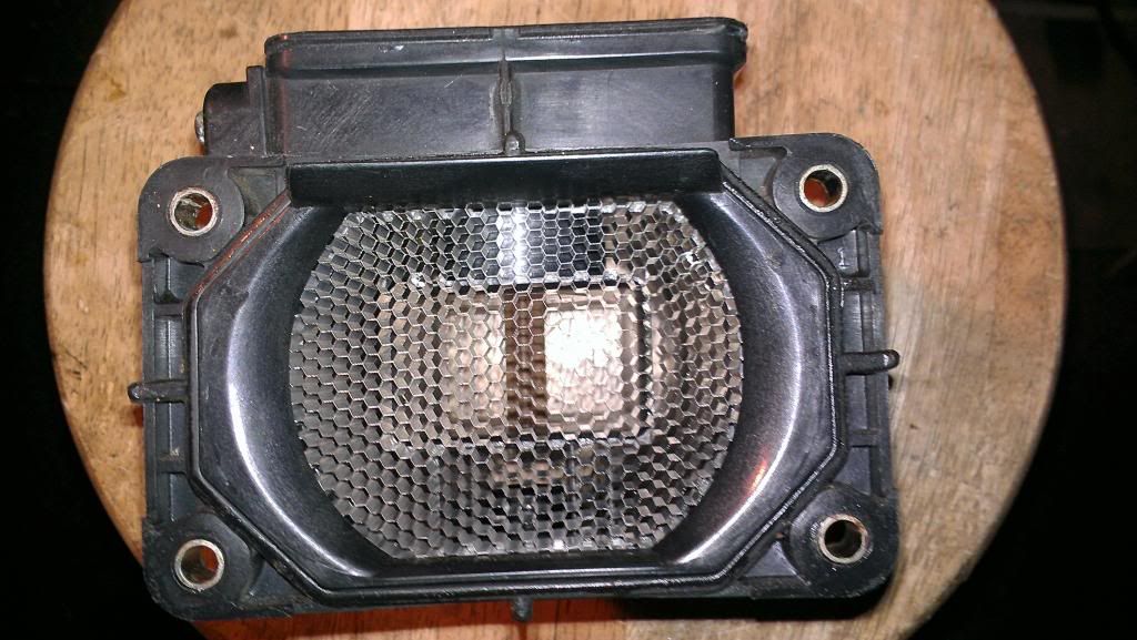

My Collection:
From top to bottom (501, 482, 399)
501
482
399
