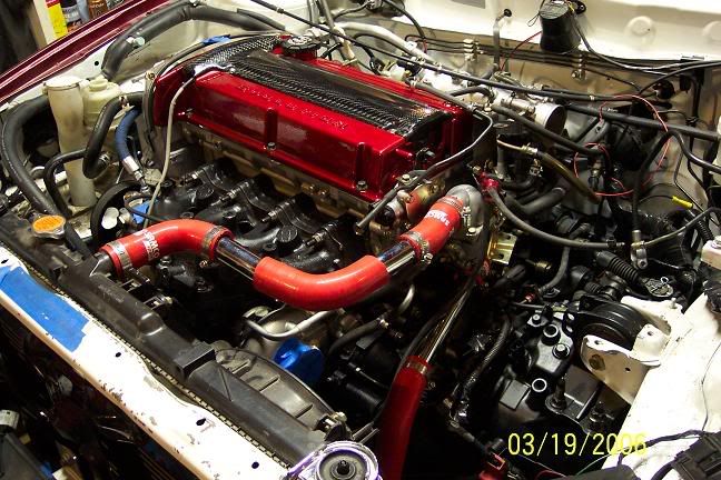

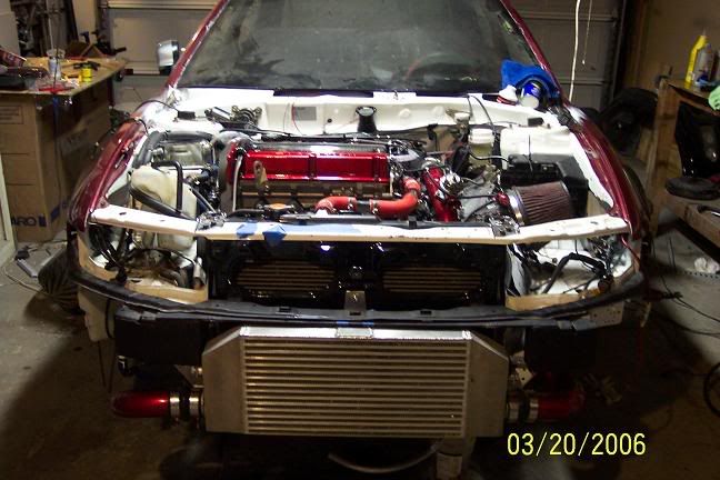

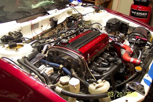

after a bunch of delays and a cracked block, i have finally finished my EVO VIII swap using the stock ecu. i was able to incorporate the ecu along with the immobilizer unit.
as some of you may know, the galants lacked the 5 speed option, so i also swapped one in along with a Quaife LSD.
everything is running as a stock EVO! even my stock tach works and my OBDII port! there is nothing im missing!
i havent really run the car hard, mostly around the block because im missing some body parts (a door, hood, bumper and license plates-im getting a paint job in a few weeks) but im currently boosting 11 lbs till i break in the motor and then i'll run the typical 20-21 lbs that most evo's run.
the good thing about running the stock ECU are the safety features, convience, and ability to flash it instead of going stand alone/piggyback.
here's my current engine mod list:
Engine/Driventrain::
4g63t motor swap, (EVO VIII) AUTO to 5 speed tranny swap (Using eclipse tranny), Fidanza flywheel, ARP head bolts, cometic head gasket, ACT 2100 clutch and pressure plate, Quaife LSD, Deyeme Solid Motor mounts, Walboro 255 fuel pump10.5 turbo hotside upgrade, Greddy RS BOV, Greddy Oil Catch can, Hallman manual boost controller, AEM intake, custom engine harness, Spearco FMIC, Earl’s oil cooler, custom candy red 2.5 intercooler piping, 3in custom turbo back exhaust, HKS Carbon Ti exhaust, RMR carbon fiber spark plug cover, Zeeklee clear cam cover, Samco radiator hoses and intercooler couplings, JDM EVO VII valve cover in candy red
