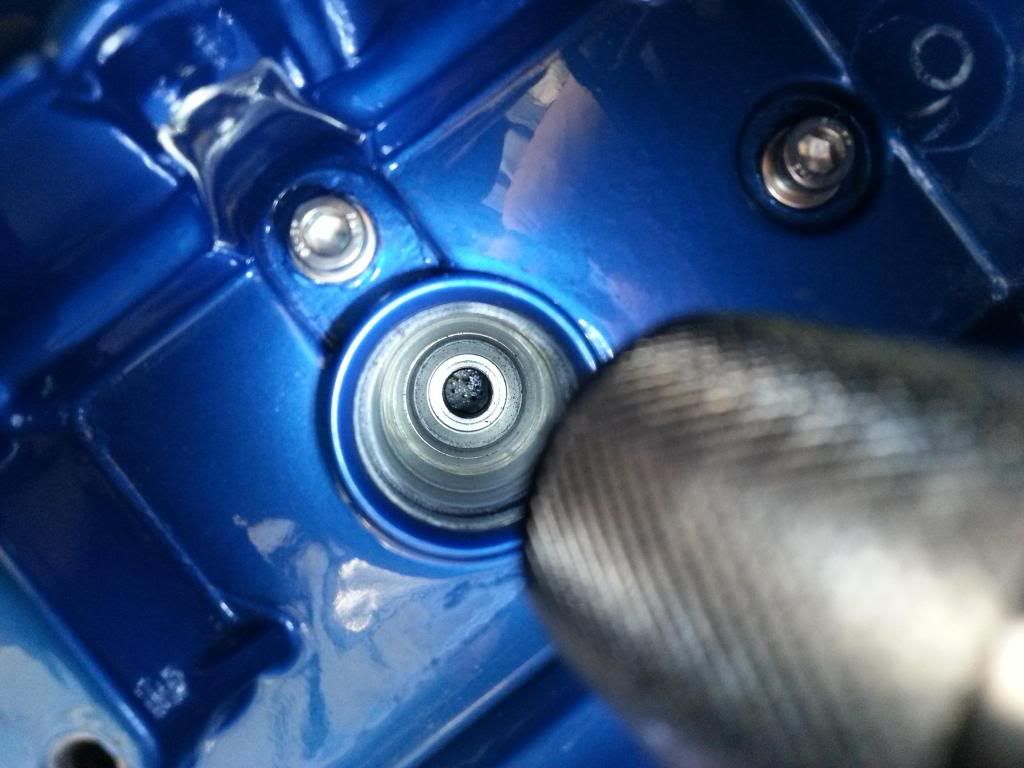

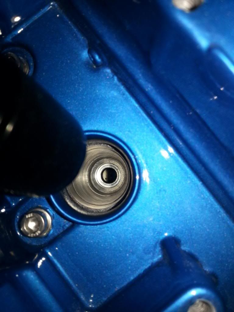

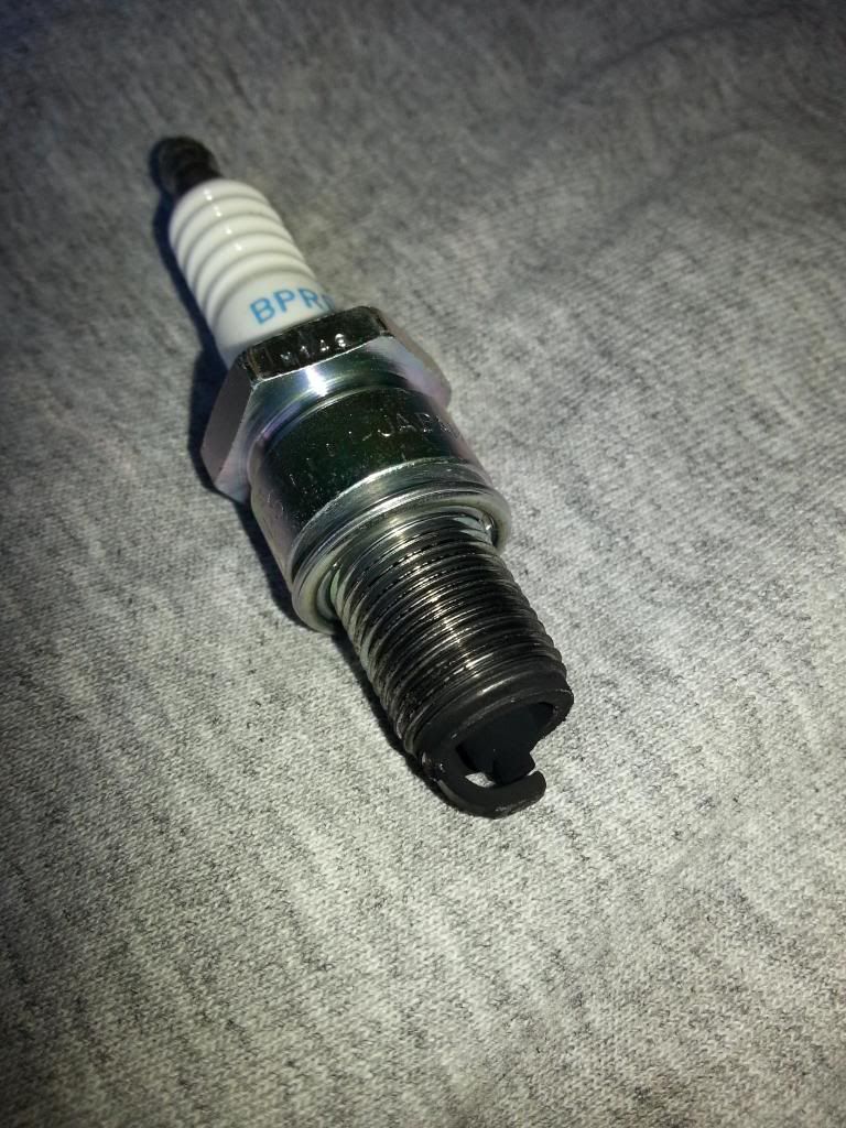

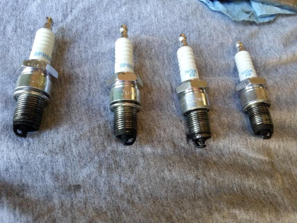

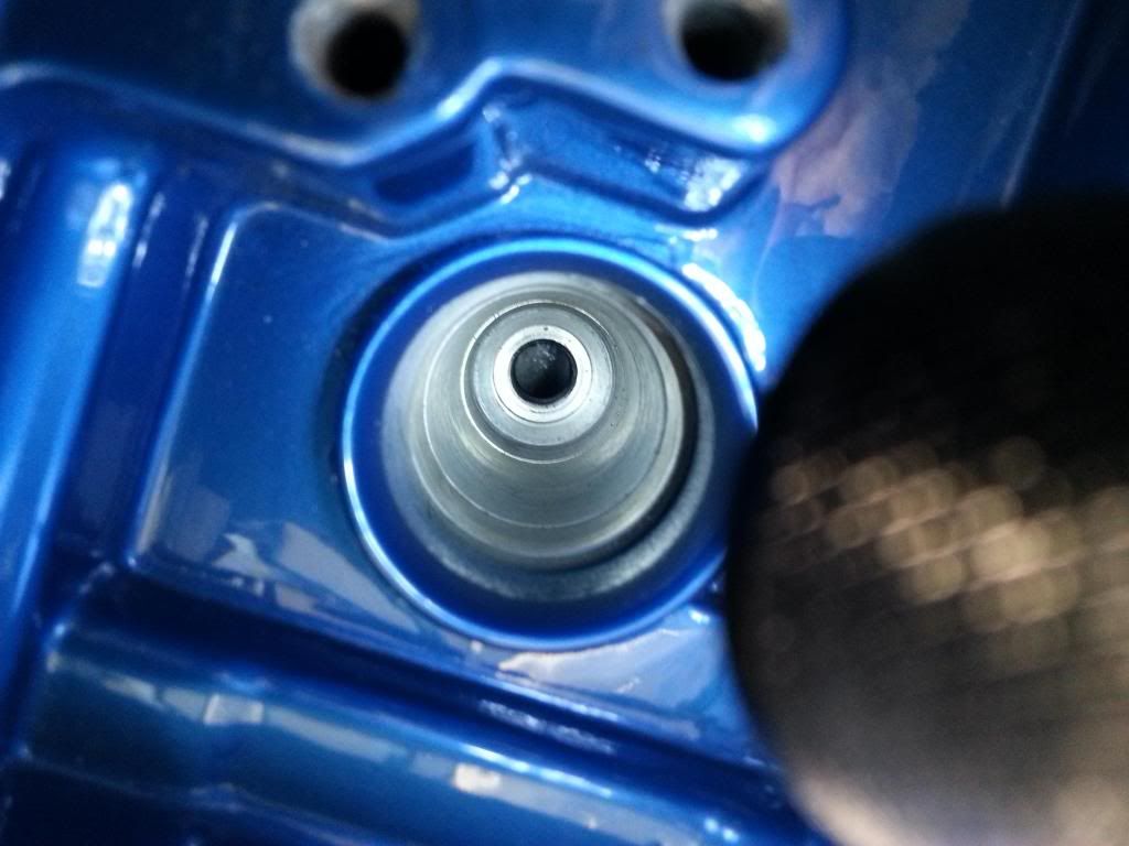

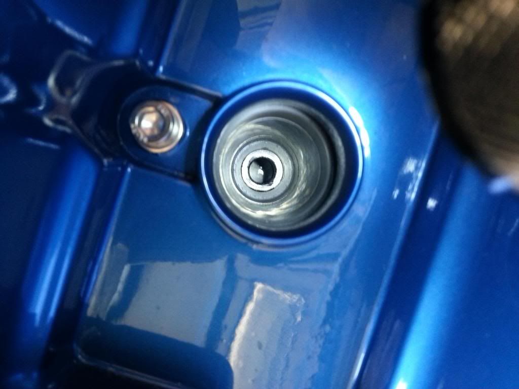

Okay I just pulled my plugs and theyre all black and wet with fuel. Cylinder one has a couple of carbon chung pieces and is slightly wet. Cylinder two is kinda dry but still has sooty stuff cylinder three is a puddle of fuel and cylinder 4 is slightly wet with fuel aswell. I called english and they said the problem is definatly the coil packs not being enough spark and my o2 sensor telling my ecu to dumb more fuel in so its running EXTREMELY rich. Like I said, im not startng it again until I have a base map tune at least but I still need to fix the issues beforehand. So with all the un burnt fuel, is it JUST the coil packs and no tune? Or is it possibly something else aswell.
The carbon/soot chunks in cylinder one and two kinda scares me. Ill post pics tomorrow or later tonight when I get off work. Plugs look like theyve been soaking in alky and are black and moist.

Your AFR's are probably in the 8's. Without a MAF the ECU goes into limp mode which is a throttle position by RPM based fuel map that dumps a whole bunch of fuel. That is to say it dumps a bunch with stock injectors, with the giant ones you have in there I'm honestly surprised the car even runs.
#21 ·
He said he's running a stock 3g ECU with a stock ROM, no tuning has happened yet. So yes, he will run into limp mode immediately because without the MAF plugged in you don't get hertz, baro, or IAT which are the 3 factors that our ECU uses to calculate air flow. Thus limp mode. With huge injectors. And so running pig rich is a dramatic understatement.
Okay thank you for the info. Is this also the reason my exhaust was popping and why it sounds like a 4 stroke quad? And yeah I can see my reflection in cyl. 4 and it dont look to pretty lol..... do you guys think I ruined anything?:/
The 4 stroke quad sound to me means your firing order is off. You can swap a couple wires around on the V6 to make it sound like a harley. But it could be due to the richness also. If all four plugs look the same it's probably just the excess fuel.
I highly doubt you've ruined anything other than maybe the engine oil. Running all that fuel will result in a lot of it running right past the rings into the oil, otherwise it'll simply carbon foul the plugs and chambers but that's nothing a new set of plugs and a run WOT won't fix.
