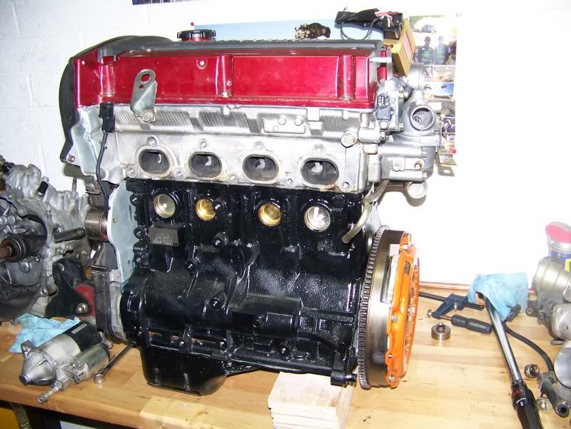

4G63 block w/ 4G64 crank = 2.3l
277 whp 315 ftq

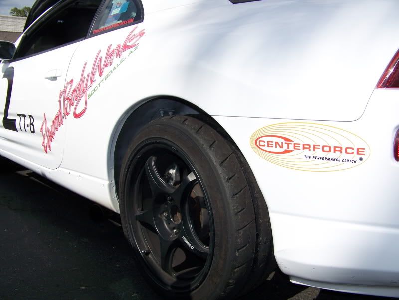

Centerforce Clutch-awesome clutch hook up
Elwood body in Scottsdale -made the car look all pretty
Big O Tires of Scottsdale- comes in handy for race tires

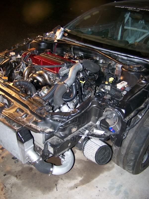

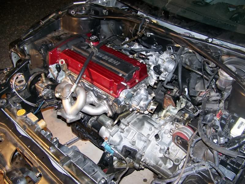

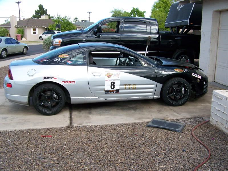

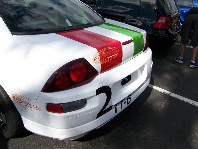

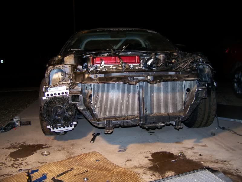

Here is how the car started

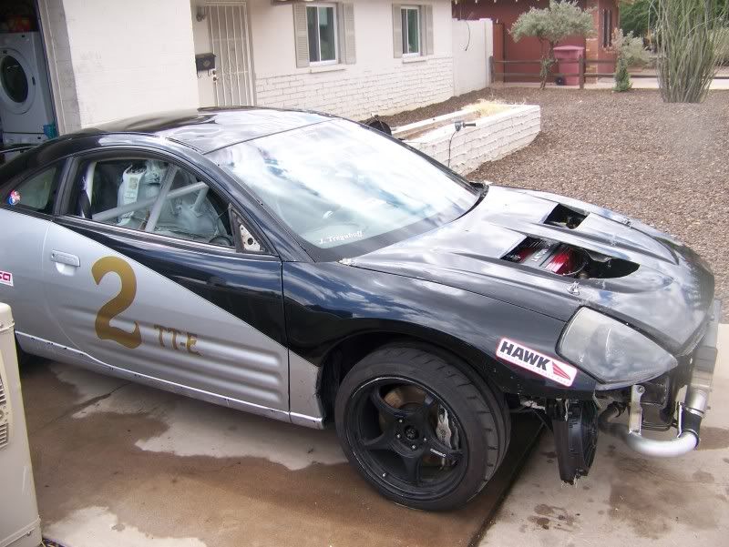

Then it got its first paint job
Then it started getting raced

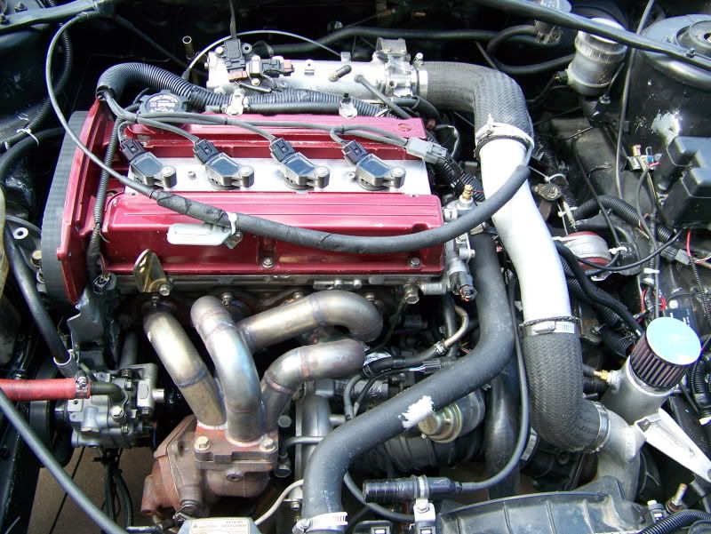

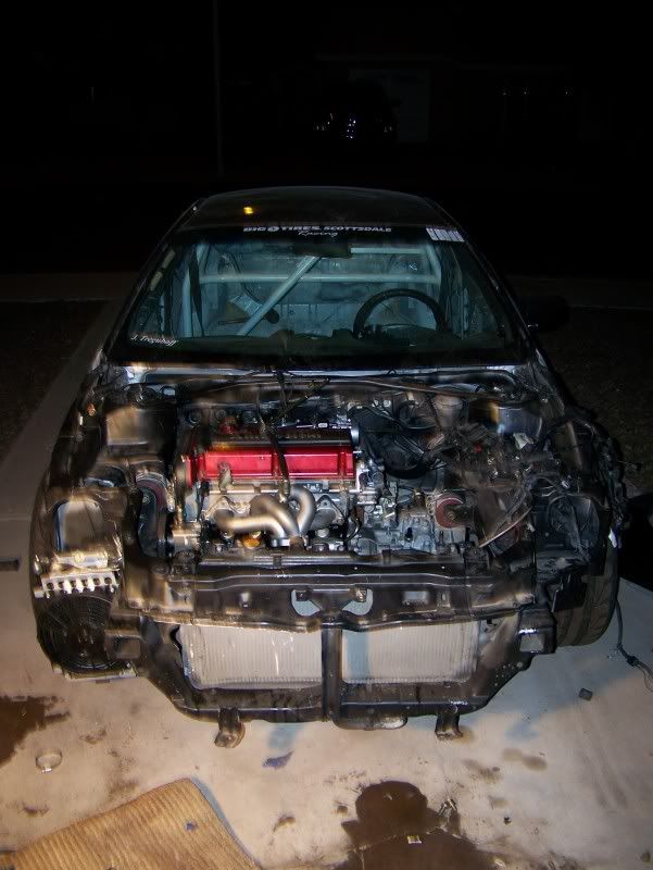

And then I decided I needed boost

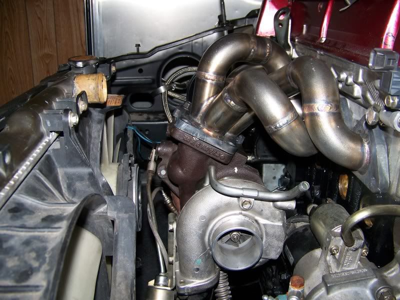

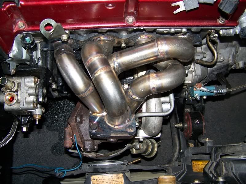

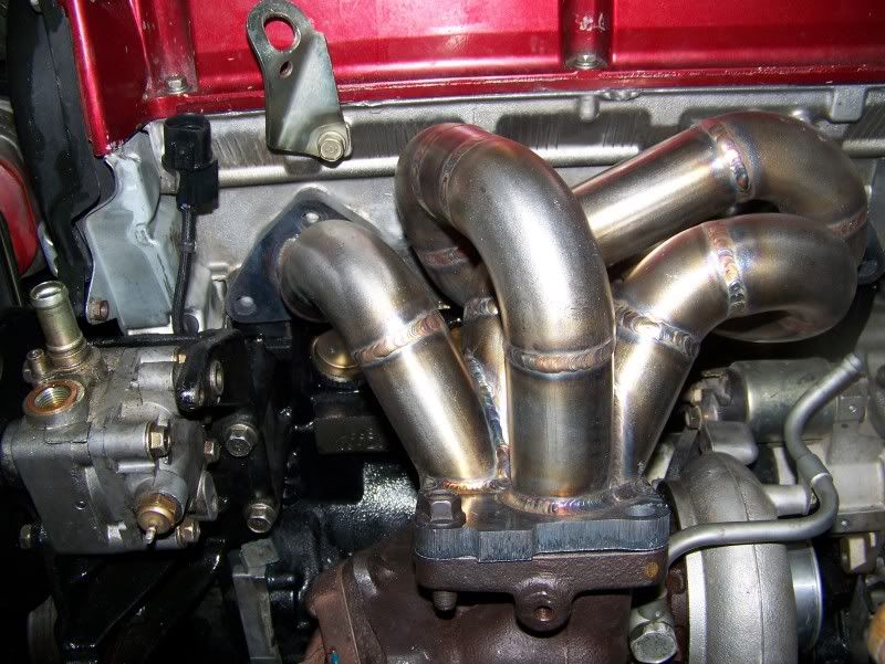

29 hours went into building this manifold

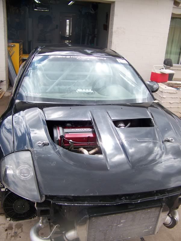

Had to do some trimming to the hood so it would fit right

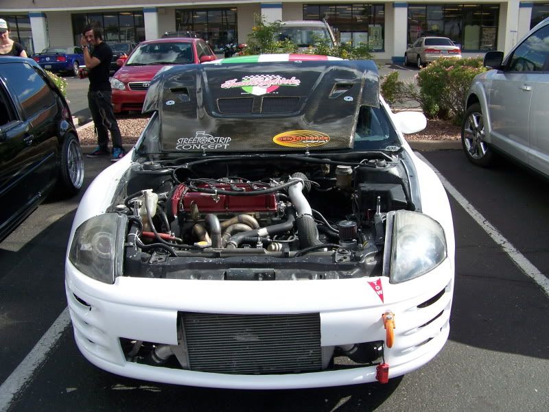

Then I got myself a body shop to sponsor me!!!
(its an Italian family who owns the body shop hence the colors)
