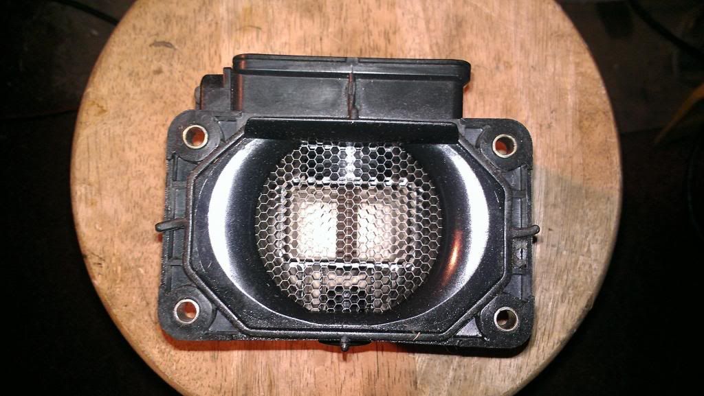

3g's came with two different MAF's throughout their production. The first and by far most common is the 501 MAF sensor.
This sensor came on all GS's, RS's, and GT's over all years.

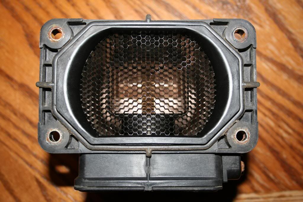

The other sensor is the 482.
This came on all GTS's, automatic and manual. It also came in some Montero Sports.

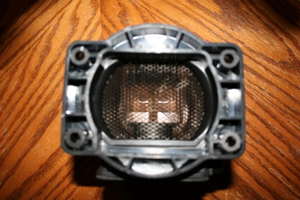

Notice the differences, 501 top, 482 bottom.

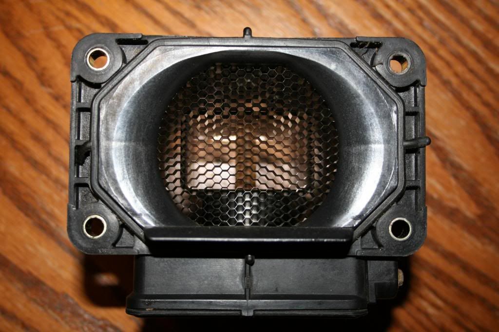

The 482 is geometrically identical to the 399 MAF that comes on the Evo. It however has different scalings. To my knowledge it has the same air metering capabilities, I have mine out close to 550 at the crank and I haven't topped it out yet. It provides a HUGE improvement in response and flow over the 501.

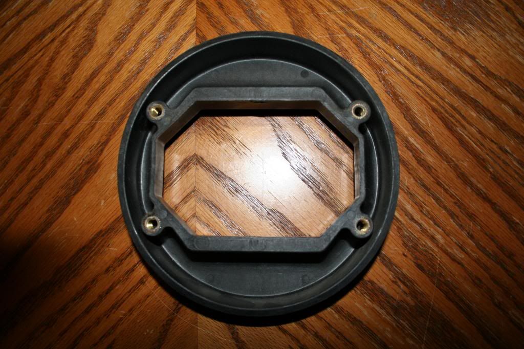

The next problem, and most common results from installing just about any aftermarket intake. Here is a comparison between the MAF plate that comes in any AEM intake and a 4.5" plate that I bought off ebay.
The result with the AEM intake plate is it focuses air into the center of the MAF. This can skew the density distribution of air through the cross section of flow through the MAF. This doesn't hurt things in stock form because the charge velocities on a stock engine or other low horsepower application aren't high enough work against an even air distribution.

On the 501.
On the 482

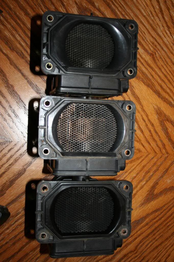

My Collection:
From top to bottom (501, 482, 399)
501
482
399

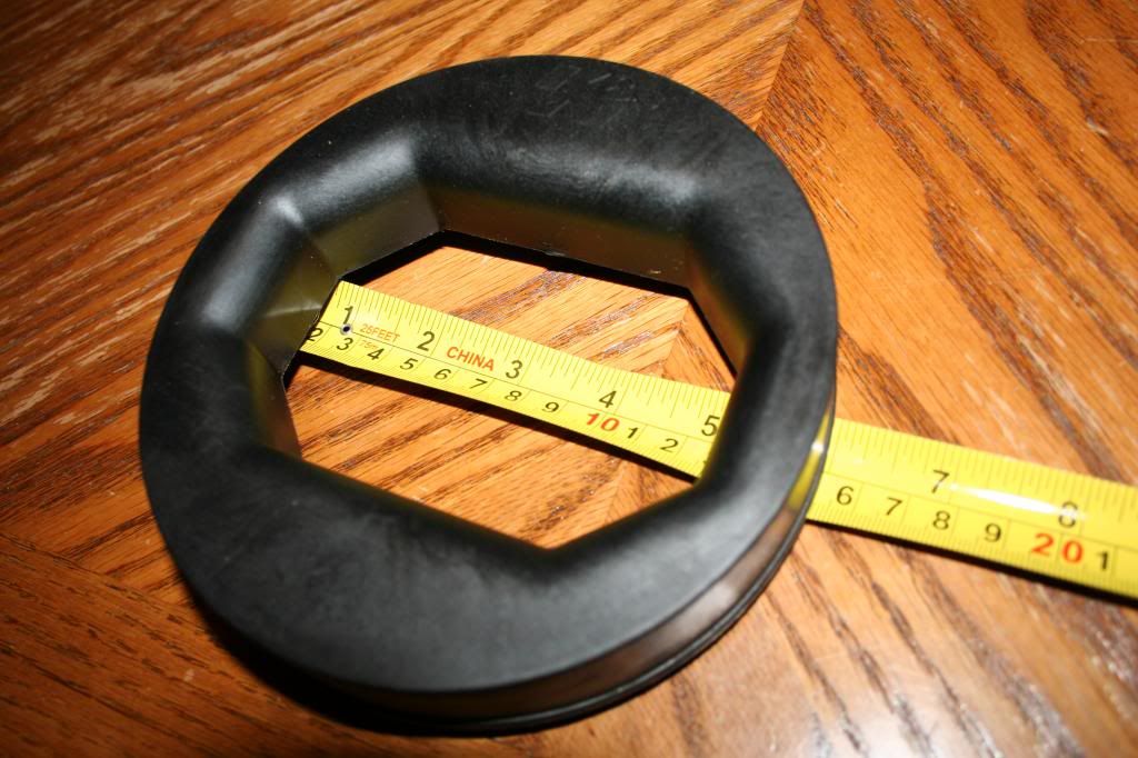

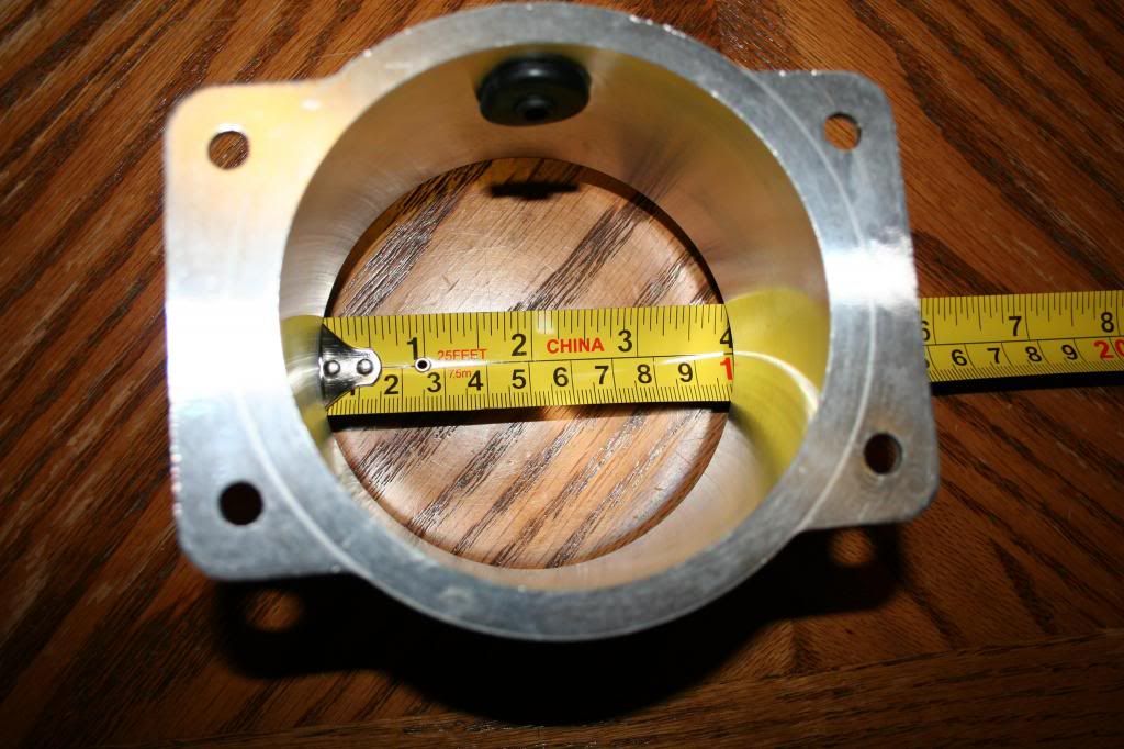

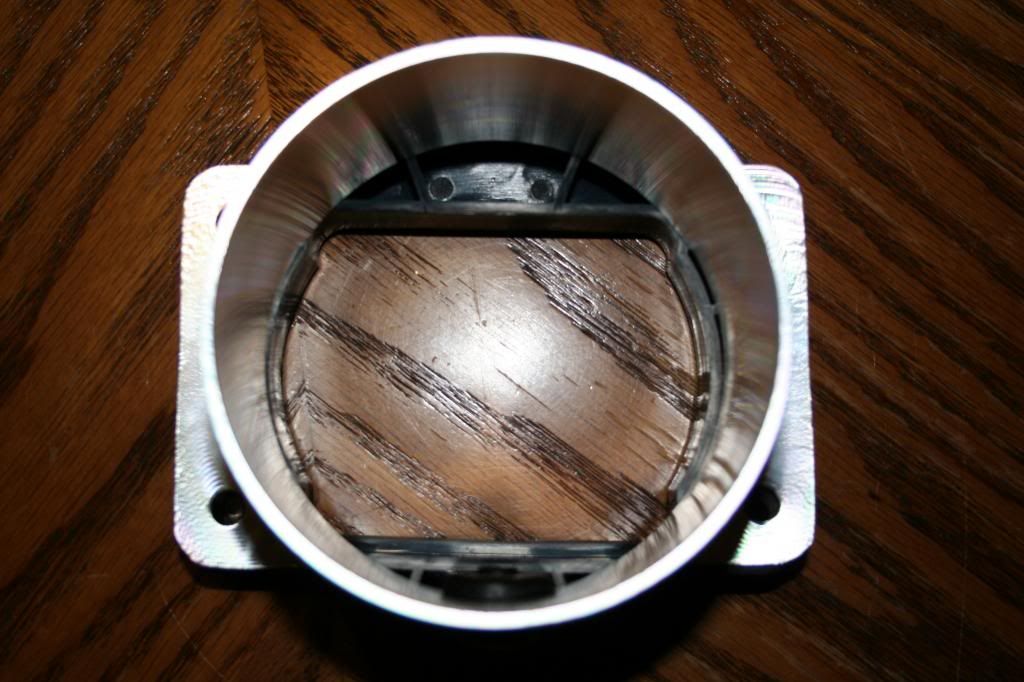

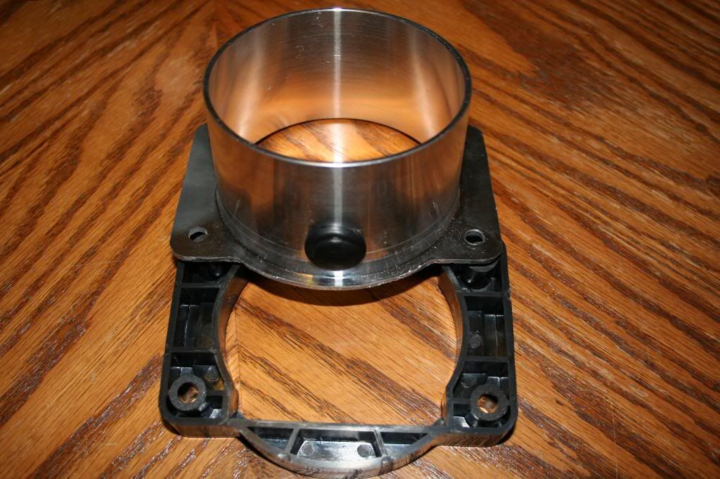

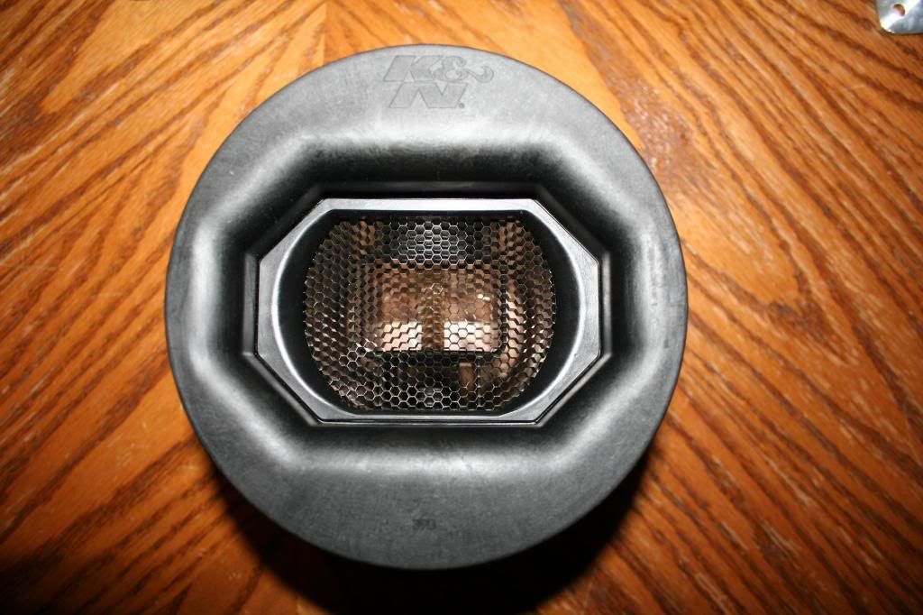

Adaptor bought from Advance Auto:
The fit:
The size: (4")

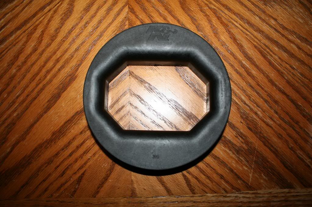

Adaptor that is sold with the Evo K&N intake:
The fit:
The size: (6")

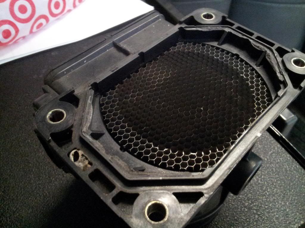

My original 501 got oil in it when I had a blocked rear PCV hose. It didn't work well in the first place so I upgraded to the 482 and tried cleaning it out. To this day the thing still seeps oil. Every time I pull it out of the drawer there is more to wipe out.
