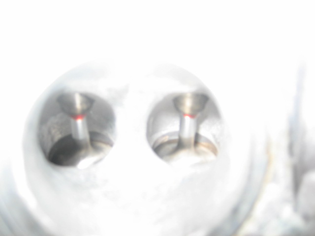

Some sneak pics for you buddy. My email is being stupid but I wanted you to see this.
How you feel buddy? Soon! :D

hey pharm, who did the head job and what are the characteristics of the heads over stock? where they flowbenched? why didnt the ports (intake and exhaust) not get polished? how much did you spend? cams, heads, and long tubes with a tune is my next move since im having much to much fun being NA right now, so im trying to get an estimate on the heads. ive seen a place that says they can do a street/strip head job for $750 for both heads. good or bad?

How did the valve train work out? Specifically the lifter pre-load? Also, did they machine the spring locators to fit around the exhaust valve guide retaining clips or did they just leave the clips out?
That was a prototype setup that I had built and I've never tried anything like it. It took like 4 months for them to get that set up to me and I told them I'd give them some feedback on how it worked out.
The valve train was assembled pretty smoothly. The locators were machined and is part of what added to the machine shop's cost. The lifter preload seems to be ok too. I bled down the lifters before install and after bolting everything down you can see that the lifters have compressed slightly but not completely. I've spun the cam gear multiple rotations and did not notice any operation that seemed out of the norm in the valve train. I guess we'll really find out after key start how it does.
