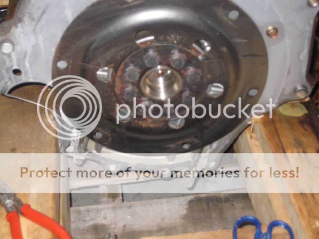

My 6g75 arrived in the mail today :) :) 49,000 miles on it.
I was going to put all these details in my members ride thread but just decided to make a swap thread instead. I will be updating with pictures and details along the way. Not sure when it will be done, Since I have never done anything like this before I am taking my sweet time and making sure I get it done right so it will probably be some time before the swap is complete.

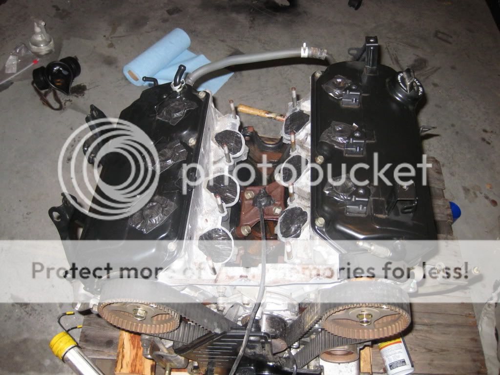

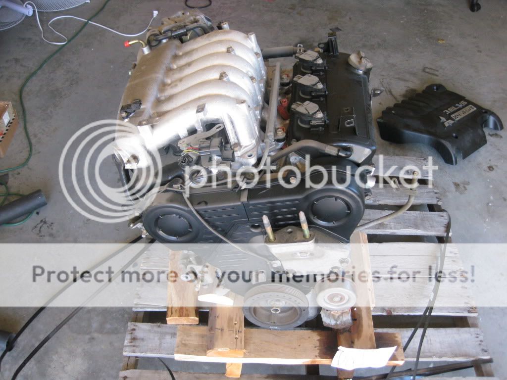

Here are the first pictures I took when it arrived at my house today.

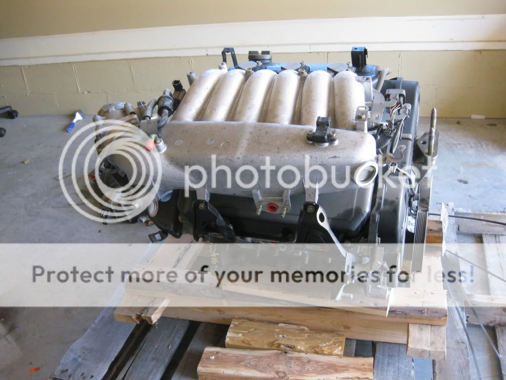

After taking some things off and trying to clean it up a bit.

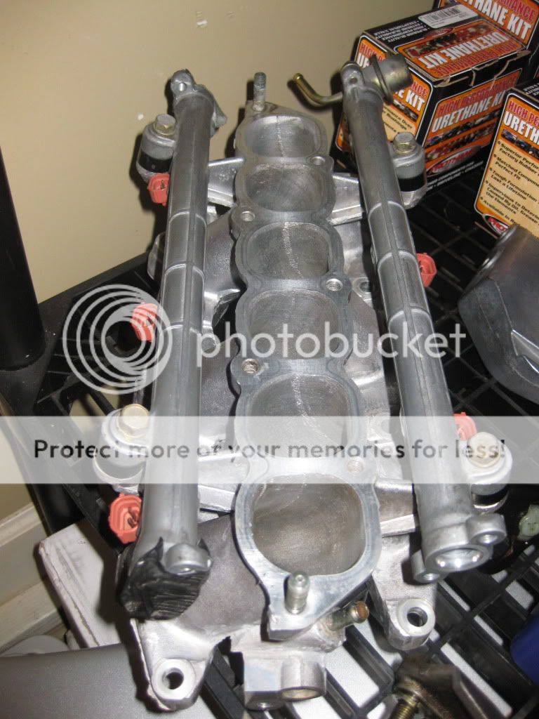

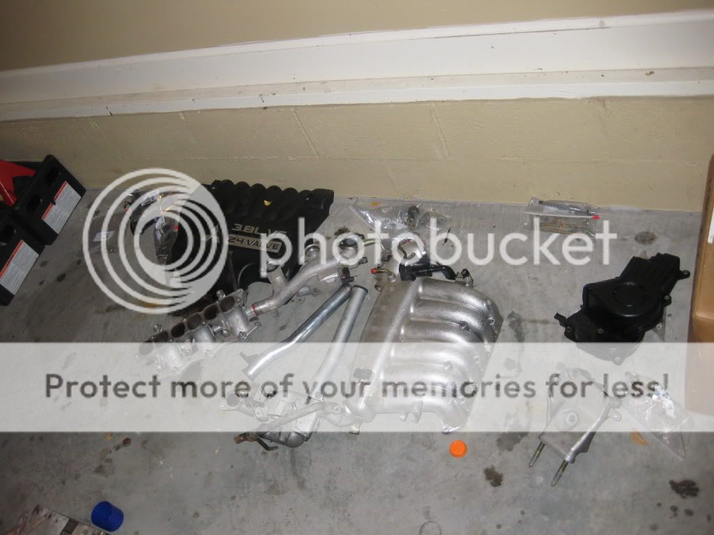

74 fuel rails and lower intake manifold, with 75 fuel injectors

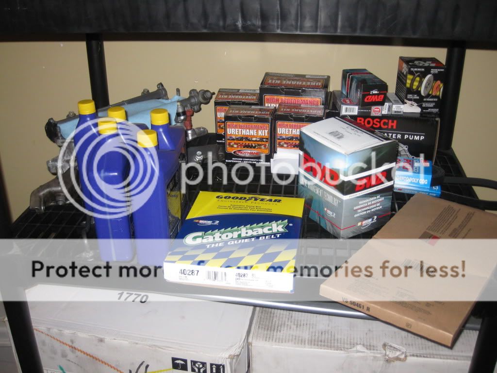

Parts and Bolts are piling up quick!!

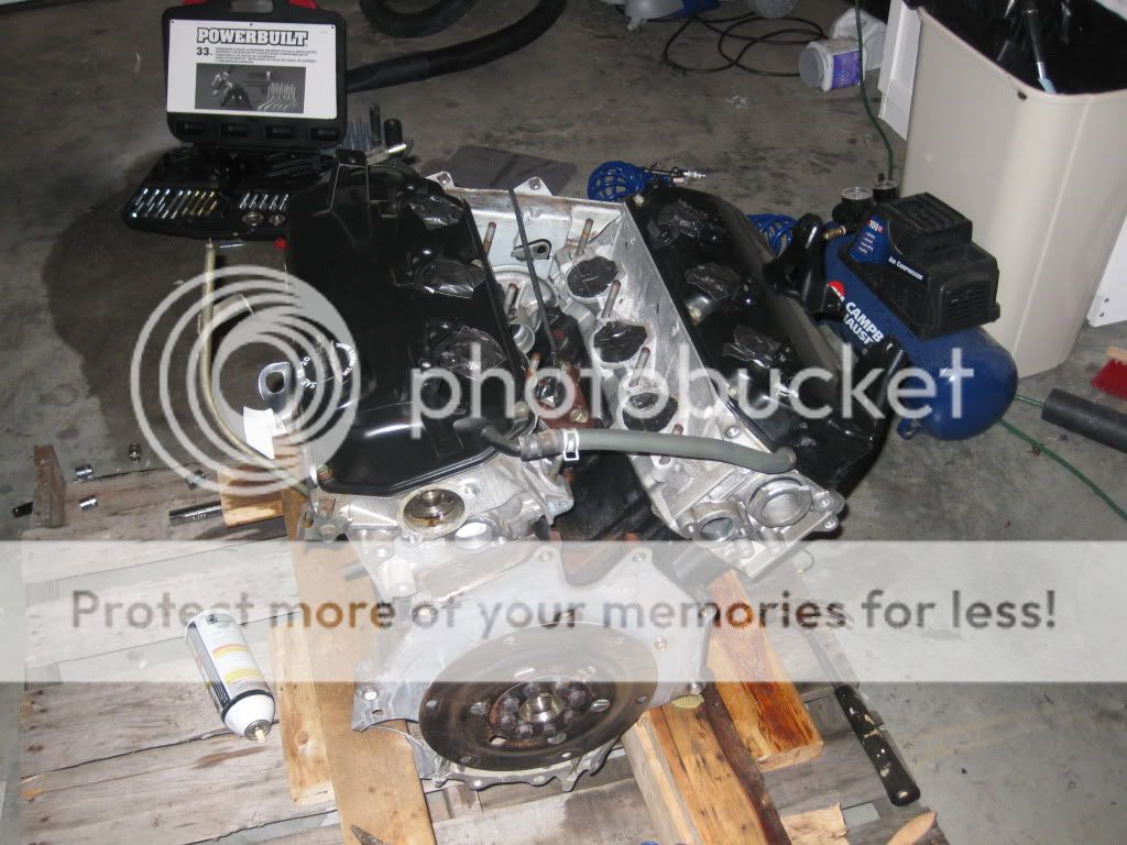

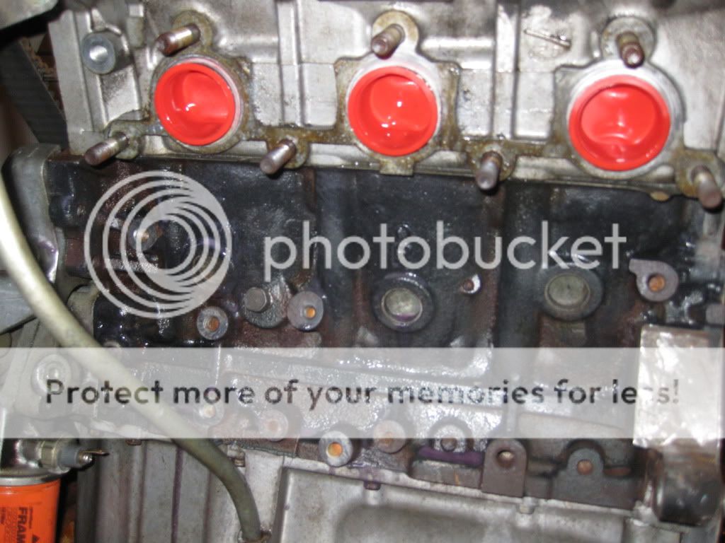

Ok so I have a question about this picture, I bought some rust dissolver gel and have been generously applying it to the block in attempt to clean it so i can prep it for paint but its not doing shit. My friend let me borrow his dremel so I guess I could use the sanding bit but that would take fooorreeevveer..Any suggestions on rust removal/ prep work for painting the block?

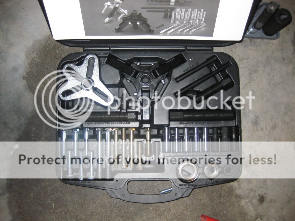

Crank Pulley Kit I rented from advanced, either I am doing something wrong or this kit dosnt have the right tool but I can not for the life of me get the dam crank pulley bolt off. Tried impact gun and breaker bar. So I am stuck here until I can get this bastard off.

Looks good. As for the crank pully, I haven't pulled one off our cars, but if there are 2 bolt holes in the crank your going to want to use the silver adapter. That cone adapter inbetween the silver and black adapter, your going to want to thread the big bolt into either the silver or black one. Then put the cone in the end of the black bolt. Next line up silver or black on onto the pulley with the cone centered. You should get an idea on what to do.
I was using the silver adapter earlier, putting two bolts through it into the 2 holes on the pulley. Then sticking an open end socket through the middle of the silver adapter into the crank bolt,then attaching an extension+breaker bar to it. Then turning counter clockwise while a friend was holding another breaker bar in between the bolt to apply force clockwise in order to keep the pulley from turning counter clock wise. This did not work though.. IDK I think I need to get one of these

As far as the rust goes I bought some carbon steel wire brushes for my 30k rpm dremel and it dosnt do shit. Some places with light rust will start chipping away but the majority of it is unaffected by them. What do I do about this DAM rust!
Luke: I wish I had something to rig up to get the bastard off but the only things I have didnt work. I am going to try and hunt down this mitsu specific tool I need, I hope its not going to cost a shit load of money though for something I will probably use a few times.

Also, the way I got my pulley off was get Locking Chain Pliers from Autozone or so, chain up the pulley, make sure the pliers have something they can grab on to, and break off the nut with a breaker bar. See if that helps.

pharm: I realized this after a few hours spent cleaning, I decided to just get rid of as much rust as possible, degrease it, clean it and then spray some engine enamel on it and call it a day. No points in spending so much time when A) like you said it will just look like that again and B) you cant even see any of it when the engine is in your bay.

Got the crank pulley off finally! Almost took my friends finger off doing it but we got it. Also I have everything pulled off of my 72 thats in my car,only thing left is the axles and the mounts and then the engine/tranny will be ready to come out.

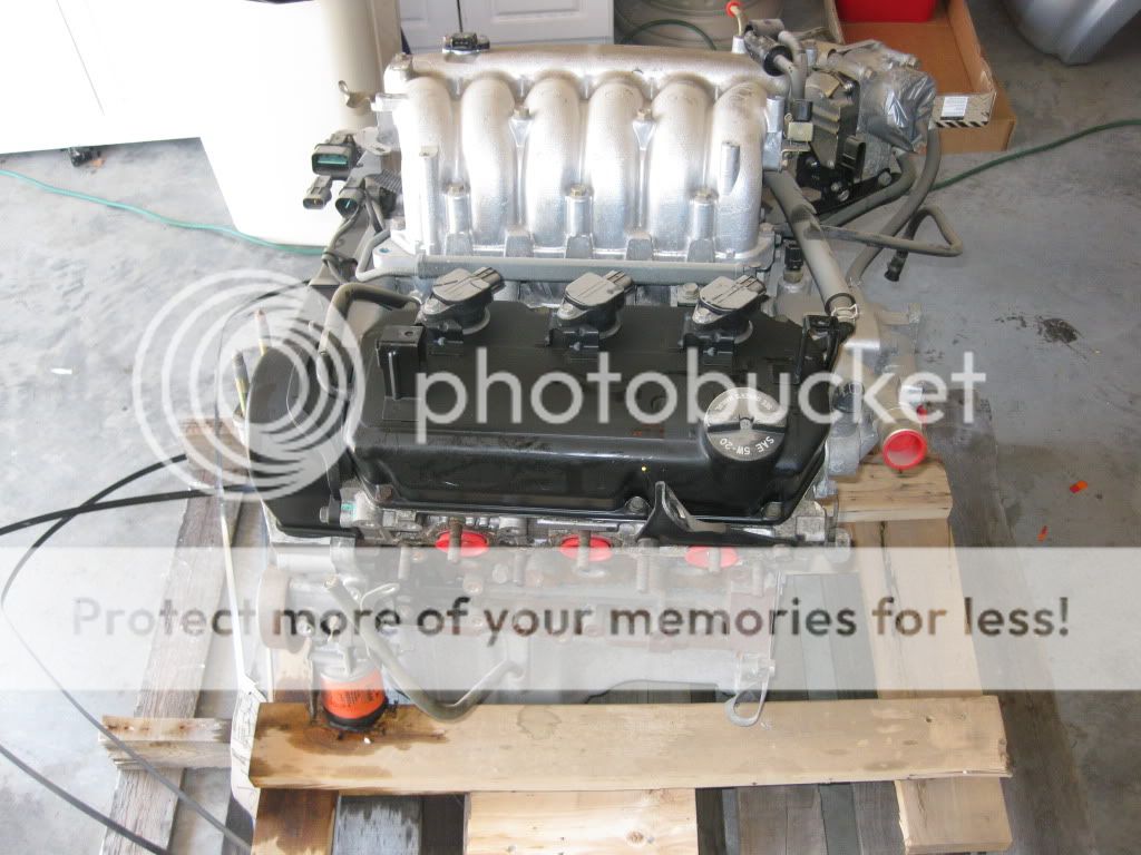

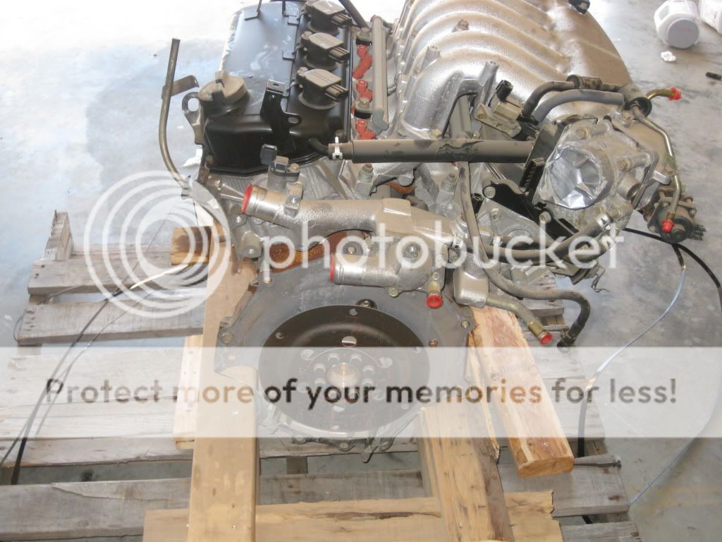

I also have pictures for everyone,first few pictures I wanted to ask everyone what they thought about the condition of everything you see,I thought it looked pretty dam good but wanted second opinions.
