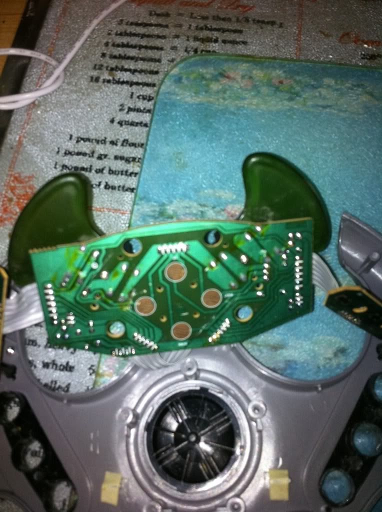

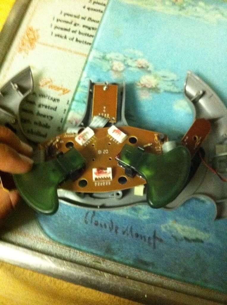

Just so you understand I'm not all talk and have no knowledge, I dissected that xbox steering wheel. As I thought it is all just circuit board running off 5volts.
So it's really simple, each of those paddles has it's own little trigger system. It's a double trigger so it can be pushed forwards or pulled to activate it. All I'd need to do is desolder these two units, and wire each one up individually on each side of the steering wheel. As for making them run the triptronic, that's where more research is needed. I'm assuming all need to have the toggle switches click on a relay so I can use it to manipulate 12v instead of just 5, assuming that's how the sportronic shifts by either using a negative or positive pulse. I'll end up making new paddles, or ordering some to fit onto the plastic ones. Those wont hold up I'm sure. All it is is plastic paddles held on by a plastic pin horizontally and two push rods on the bottom that click each side of the trigger units.
