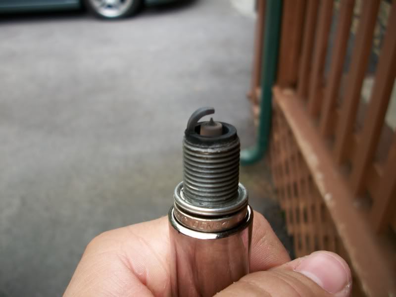

The car is not overheating, and does not seem to have lost any power. I have pulled all the plugs and they all look like this.

On a side note, to me, the plug in the pic definitely looks like the car is running too rich, not lean... you're not running on boost so you are OK to lean it out a bit IMO... have you tried doing a fuel injector cleaner on a tank of gas in case the fuel rail you swapped in has some crap or has messed up an injector?
Btw, are any of the plugs oily? That may tell you head gasket issues at cylinder(s) where oil is getting into a combustion chamber and burning = blue smoke...

The plugs were not oily. Like I said, they all looked like the one pictured. And the coolant looks fine. Strange thing though. When the engine is all warmed up the overflow tank is past fool, but when its ice cold the tank is below low. Dont know if that is something to look at. I am thinking its valve seals and guides as well. But im not sure how hard that is to do yourself. Trying to decide if I want to just bring it somewhere.
